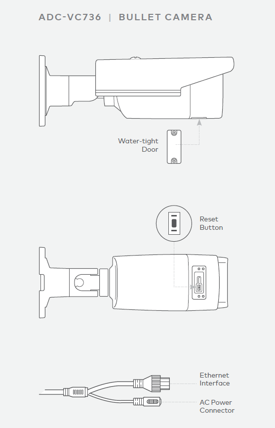

If you have issues connecting the camera to the account, power cycle the camera and try again.
If issues persist, reset the camera to factory defaults by following these steps:
  • Disconnect the camera from the power supply.
  • Use a Phillips-head screwdriver to remove the water-tight door on the bottom of the camera and locate the Reset button.
  • Press and hold the Reset button while reconnecting power. Continue to hold the Reset button for 10 seconds.
