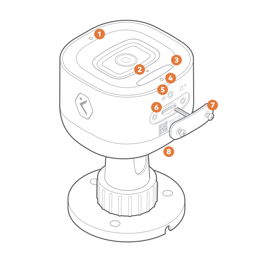

Overview
  1. Ambient Light Sensor
  2. Microphone
  3. Spotlight
  4. Status LED
  5. WPS/Reset Button
  6. SD Card Slot
  7. SD Card Door
  8. Speaker

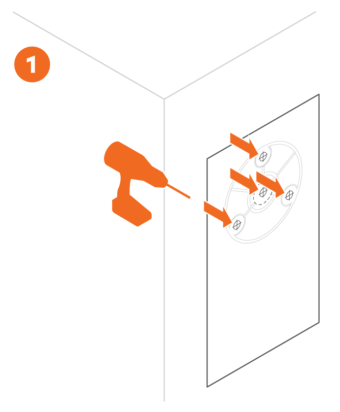

  1. Use the included drill template to mark the desired location of the holes for the power cable and mounting screws. Drill a 1/2” hole in the center of the template for the power cable. If mounting to drywall, drill three 9/32” holes and insert the included M5 wall anchors. If mounting to a solid surface (e.g., wood), drill three 1/8” pilot holes.

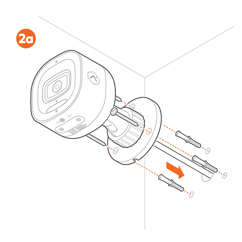

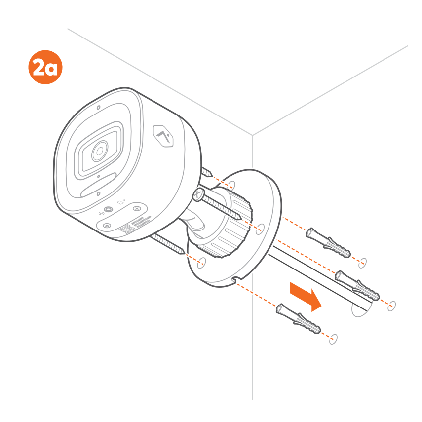

2a. To mount the ADC-V730 when routing the power cable through the wall:
  1. Install the rubber plug over the hole for the power cord.
  2. Connect the 12 VDC connector to an unplugged 12 VDC adapter. Insert the power cable into the center hole.
  3. Line up the camera with the three holes created in step 3. Use the included ST4.8 x 32mm self tapping screws to fasten the camera to the mounting surface (#10 drywall screws or 3/16" Tapcon screws are also acceptable).

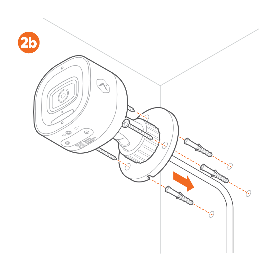

2b. To mount the ADC-V730 when routing the power cable along the wall:
  1. Remove the rubber plug from the power cord.
  3. Line up the camera with the three holes created in step 3. Use the included ST4.8 x 32mm self tapping screws to fasten the camera to the mounting surface (#10 drywall screws or 3/16" Tapcon screws are also acceptable). Route the cable through the cut-out in the mounting plate.
