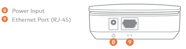

  1. Use an Ethernet cable to connect the Smart Gateway to an open Ethernet (RJ-45) port on the existing router.
  2. Connect the Smart Gateway’s DC power adapter and plug it into a non-switched outlet.

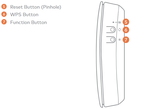

Wi-Fi Protected Setup (WPS) mode
  • WPS mode is the preferred way to add an Alarm.com Wi-Fi camera to the Smart Gateway’s Wi-Fi network.
  • Be sure to add the Smart Gateway to an Alarm.com account before using WPS mode to add video cameras to the Wi-Fi network.
  • To enter WPS mode, press and hold the WPS button for approximately 1 to 3 seconds. The Wi-Fi LED will slowly flash to indicate that the device is in WPS mode.
    • Wait 2 minutes for the video device to connect. If the connection is unsuccessful, WPS mode times out after 2 minutes.
  • Connect no more than four Alarm.com Wi-Fi cameras to the Smart Gateway at a time for optimal performance.

Can a PoE Alarm.com camera connect to the ADC-SG130?
Yes. However, it needs additional hardware to do so. Use an ADC-W110 to connect any non-Wi-Fi video device to the Smart Gateway’s network.
The Smart Gateway itself has a single Ethernet port used strictly to connect to the customer’s router. It communicates with Alarm.com video devices only over Wi-Fi.

Press the [ R] button (pinhole) for 1 to 3 seconds (use a paper clip or tool if necessary). The Communication LED will quickly flash five times to indicate that the test was sent. Please wait two minutes before trying to use the device again.
Power cycle
Unplug the device from power for 10 seconds and plug it back in. Wait for the Power and Communication LEDs to become solid before trying to use the device again.
Reset
Press and hold the [ R] button (pinhole) for 15 to 20 seconds (use a paper clip or tool if necessary). All LEDs will flash simultaneously to indicate that the device will reset. Wait for the Power and Communication LEDs to become solid before trying to use the device again.
