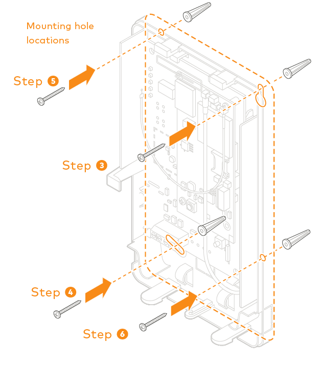

When ready to mount:
  1. Press in on the thumb tabs located at the bottom of the enclosure, then swing up the top half of the enclosure cover to expose the internal components.
  2. Place the SEM enclosure backplate against the wall at the desired mounting location and mark the four mounting holes.
  3. Using the provided mounting screws and wall anchors (if needed), place the first mounting screw through the top-right enclosure hole. This screw will be used to hang the SEM from the wall while mounting and should not be tightened until the last step.
  4. Place the second mounting screw through the bottom-left mounting hole. This screw is used to level the enclosure on the wall and should not be tightened until the last step. A standard leveling device may be used to ensure the unit is level.
  5. Place the third mounting screw through the top-left enclosure hole. This screw should be tightened fully against the unit and wall before moving to the next step.
  6. Place the final mounting screw through the bottom-right enclosure hole. This screw should be tightened fully against the unit and wall before moving to the next step.
Important : This screw is critical for the wall tamper functionality and should not be overlooked.
  1. Tighten the first two mounting screws fully to the unit and wall to complete the mounting process.

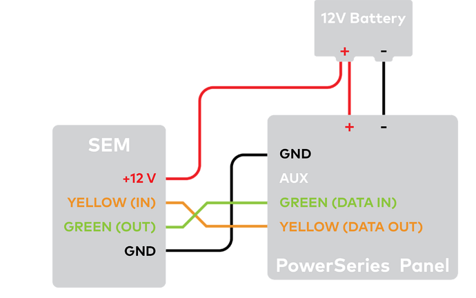

To wire the panel:
  1. Connect the yellow/green data cables and red/black power supply cables to the designated locations at the SEM and panel.

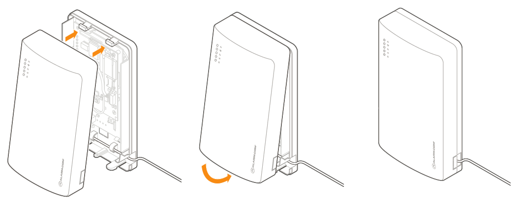

  3. Remove the snap-off plastics from the enclosure side at the desired locations, then route the cables around the internal strain relief walls and out the side of the enclosure.
  4. Before completing the mounting, verify the wiring connections are secure and all internal components are in their proper location.
  5. Then close the enclosure by sliding the cover into the mounting points at the top of the enclosure base and then swinging down the cover to snap the thumb tabs into place.

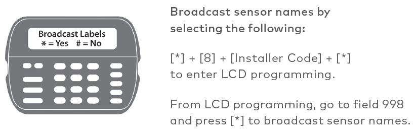

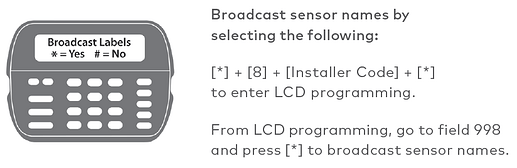

Broadcast sensor names
For the SEM to be able to read the sensor names stored on the panel and display them on Alarm.com, you must broadcast the sensor names stored on the keypads. This should be done for every install with an LCD keypad and is necessary even if there is only one keypad on the system.
