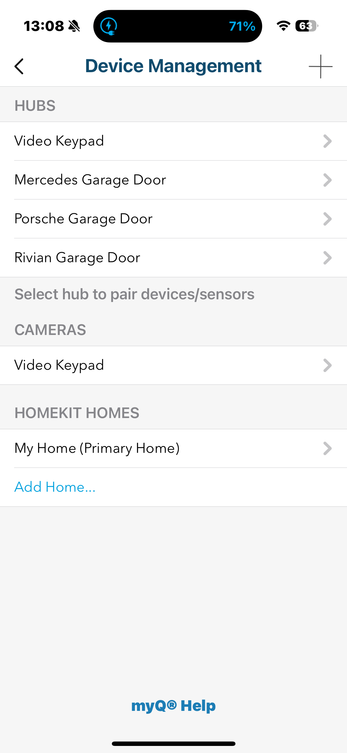

I have to say I like the Liftmaster product a lot. I have 4 products - 2 98022 openers, 1 98032 opener and 1 video keypad. It seems all 4 of these devices are considered hubs which means I donāt need a MyQ hub and donāt currently have one.
I did have some questions on the Alarm.com integration:
Does Alarm.com also integrate the MyQ Video Keypad into Alarm.com as a camera? or would it be orphaned in the MyQ app if I move across the garage door openers from the MyQ app to Alarm.com?
If the video keypad cannot move to Alarm.com, is there an alternative model to have both apps working, where I keep the openers and keypad connected to MyQ but add a MyQ Smart Garage Control paired to Alarm.com to open and close the doors?
