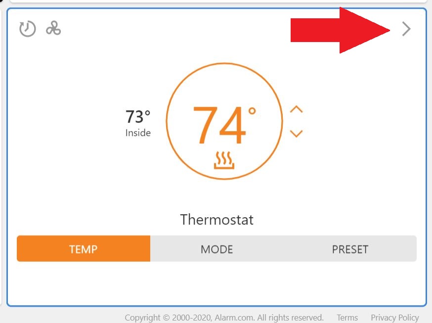

Start off by clicking the Device Settings arrow on the Thermostat card, located on your Alarm.com account homepage
