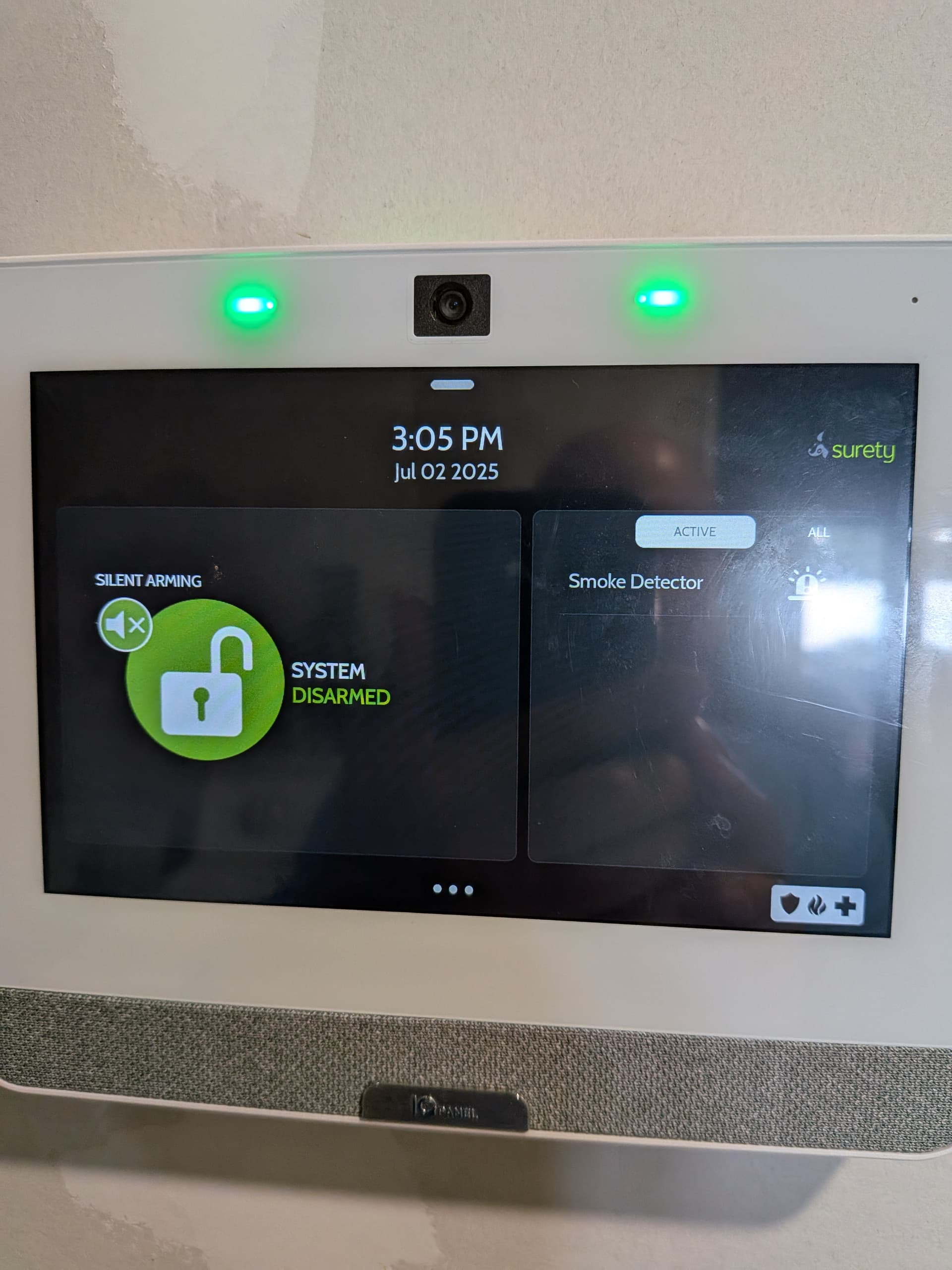

  1. panel active list showed “smoke detector” with a modified-star-burst symbol for a long time. (Sorry for the screen reflection.)

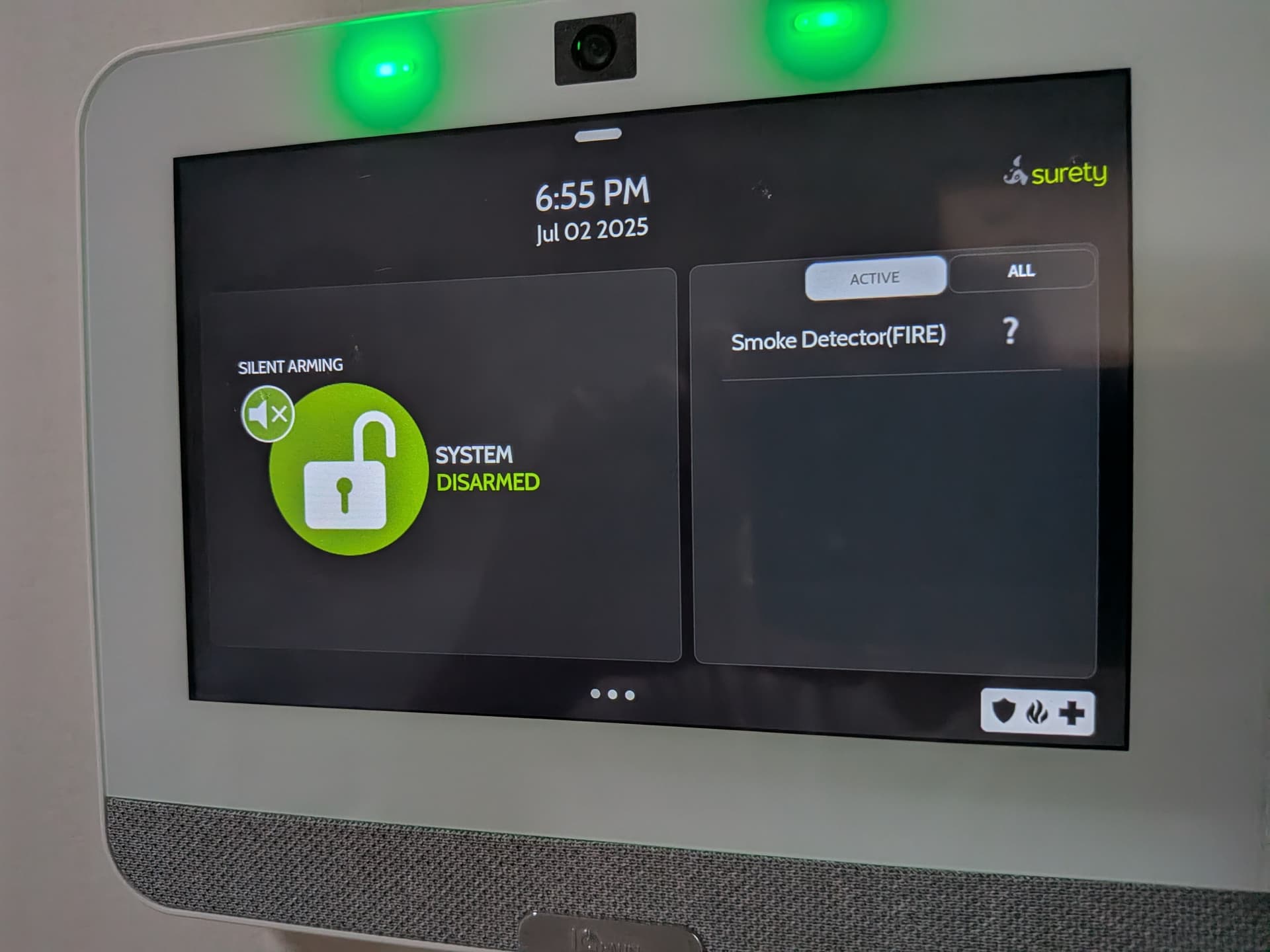

  2. after many hours panel active list became the unhelpful msg of " smoke detector(fire) ?"

The question mark meant that the device was unreachable which is possible it could have been caused since it wasn’t resetting properly. The IQ Hardwire 16F did now show any troubles which is how it communicates to the panel.
