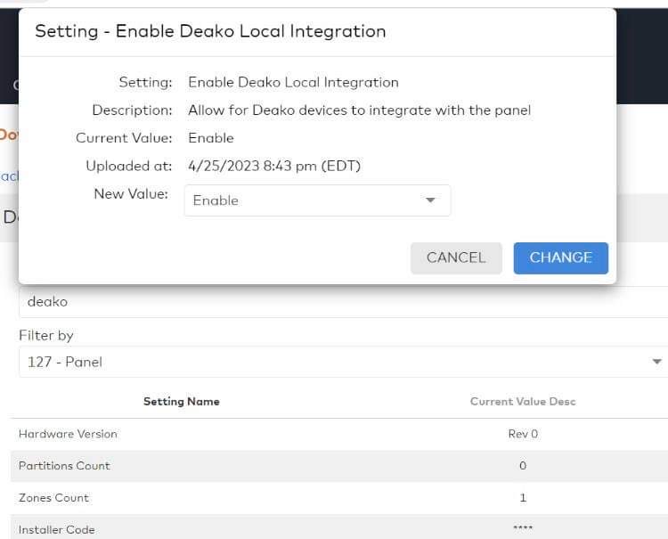

So I talked to Qolsys support who worked with ADC. They said to look for this setting in the ADC backend (ignore the name):
and they said to turn it off then on again, and this will trigger the command to the system and within 24 hours of that, the lights should then show on the panel.
Could you let me know once completed. I’ll post back in 24 hours of that if it did the trick. Thanks for the help.
I got the same response from ADC, so presumably that should work. I’ve enabled the Deako integration setting. Let us know if you have any trouble.
That section in Alarm.com is for remote management of panel config. I believe that setting is the “Other Automation” setting referenced in the installation manual here. Can be toggled at the panel as well.
