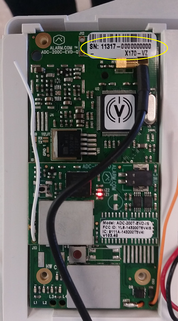

If you can’t get into installer programming, you can also get the serial number from the module itself, as shown in this pic.
Hi! Thanks for your answers. I entered that serial number and it says the module is already registered. Must be to the prior owner??. Do you know how I can take over the module as my own?
You would have to contact the company who was monitoring it and have them delete the Alarm.com account your panel is connected to. Another potential problem is that it needs to be a 4G module. If it’s 3G then you can’t create a new Alarm.com with it. Do you know which company was monitoring it?
