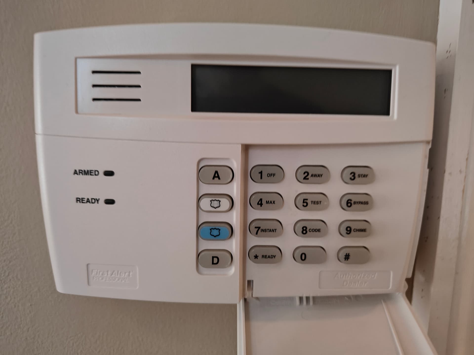

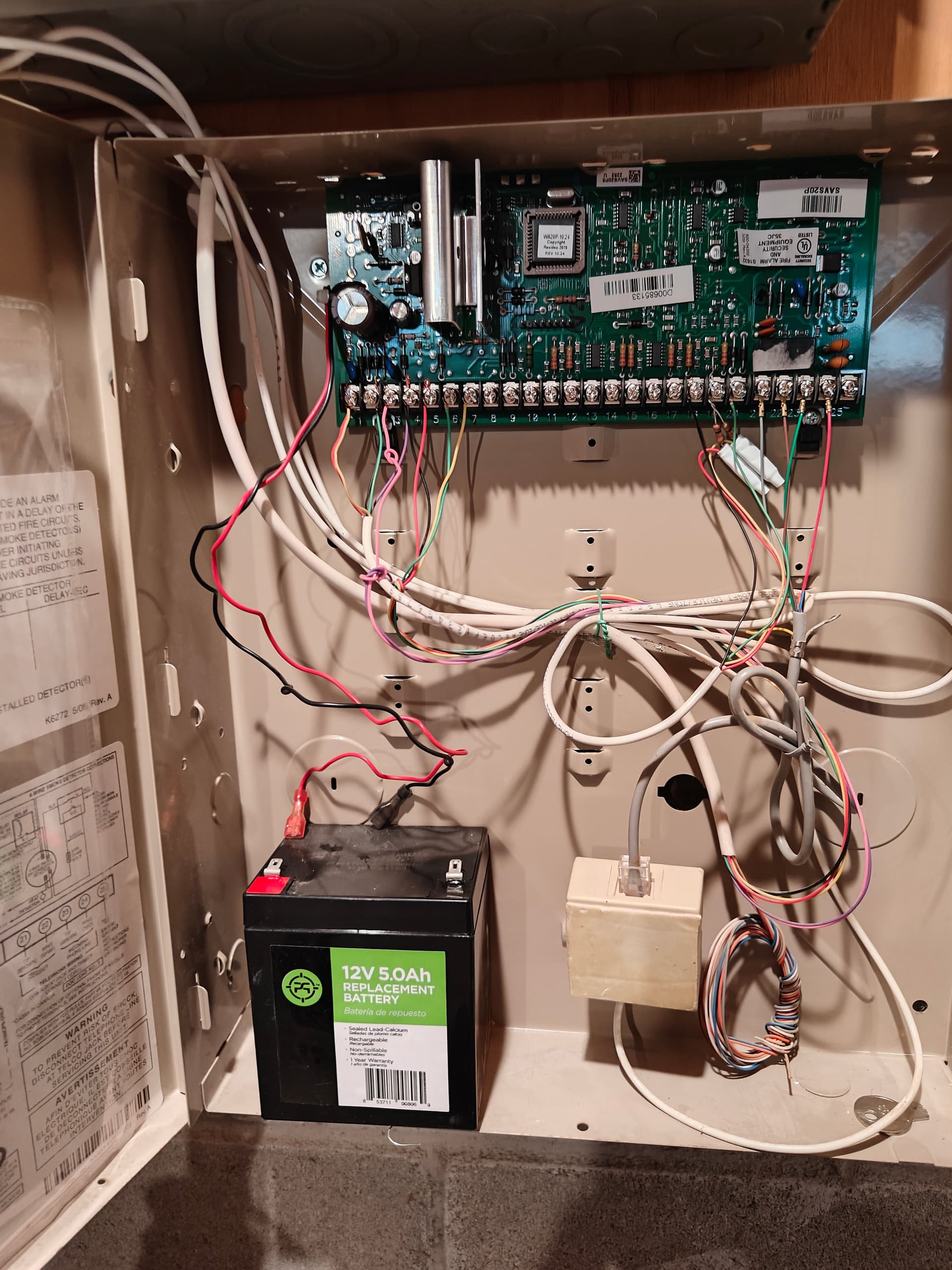

Post some pics like keypad and sensors and Control box
You would be able to reuse wired sensors with the IQ Panel 4.
If using the IQ Panel 4 IQP4001, you would need a hardwired to wireless takeover module like the PowerG IQ Hardwire (8 Zones, 2 Units max) or the Qolsys Hardwire 16F (319.5Mhz) (16 Zones).
These would replace the old panel (the case with all the wires leading to it) and transmit the sensor status wirelessly to the IQ Panel 4.
