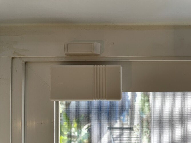

Is that sensor just using the built in magnetic reed switch or a wired sensor input? Can you post a photo of that sensor in its installed and closed position on the window?
Built-in magnetic reed switch.
Shoot: not sure why the pic is sideways.

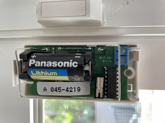

Can you confirm the TXID on that sensor? It will be printed on a sticker on the inside of the sensor. 7-digit number
045-4219
Check your Kitchen Window sensor programming. It looks like there is a TXID mismatch. The zone is reporting a programmed value of 041-6347
Bingo. All fixed now - thanks!
