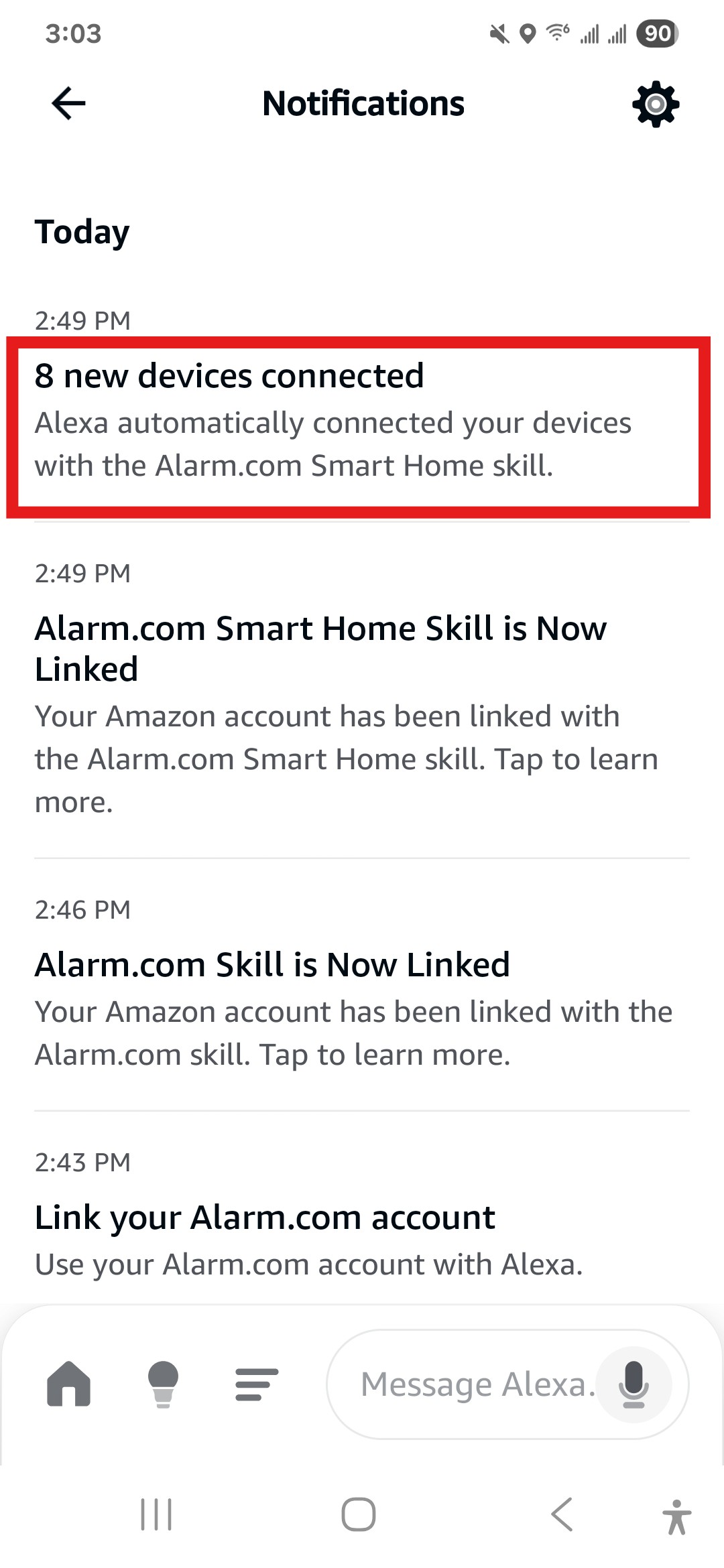

Just to confirm, you have linked the alarm.com app with your Alexa account correct?

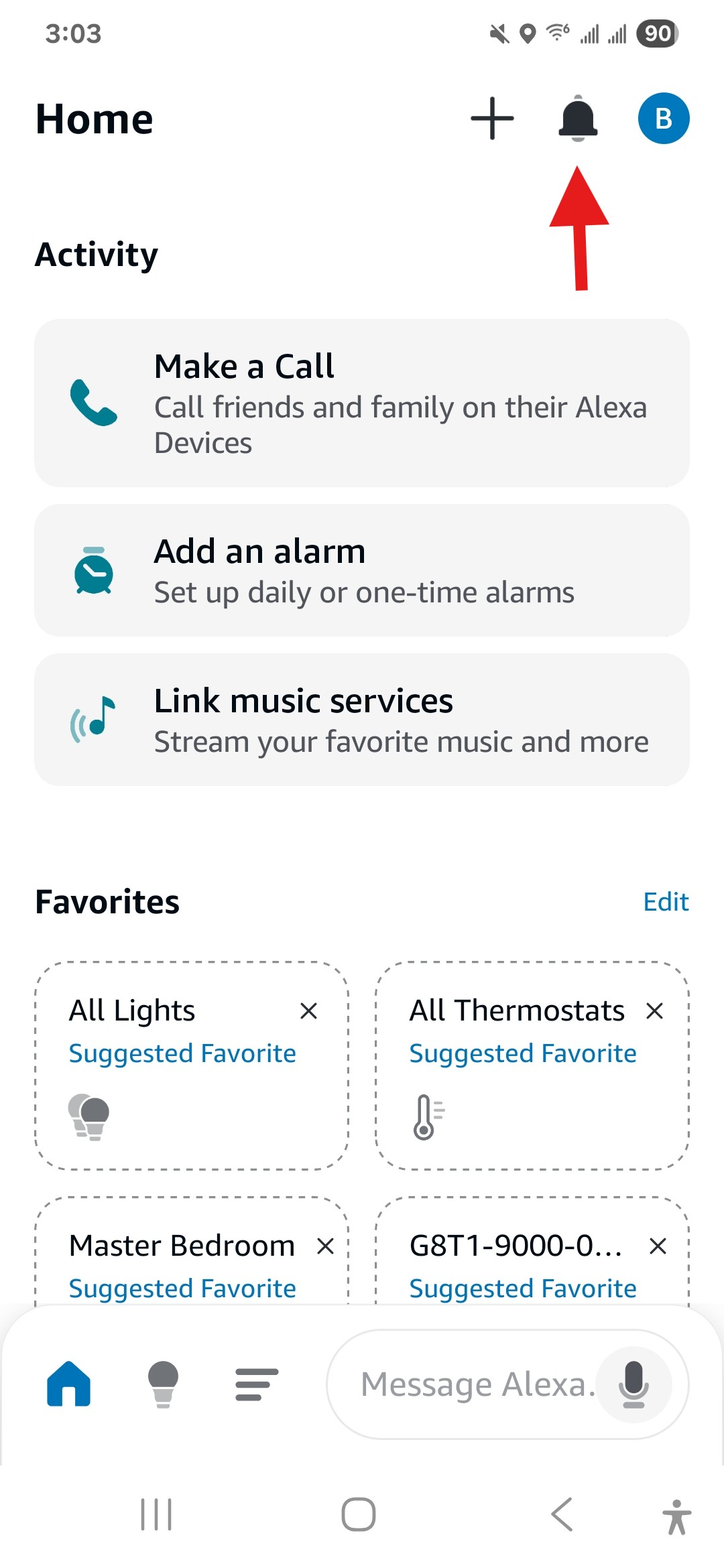

On your Alexa app, if you press the notifications Icon on the top, does it display that devices were added through your Alarm.com account?

That worked. Thank you for your help.

The devices may need to be added to groups/rooms in order so you can see them.
