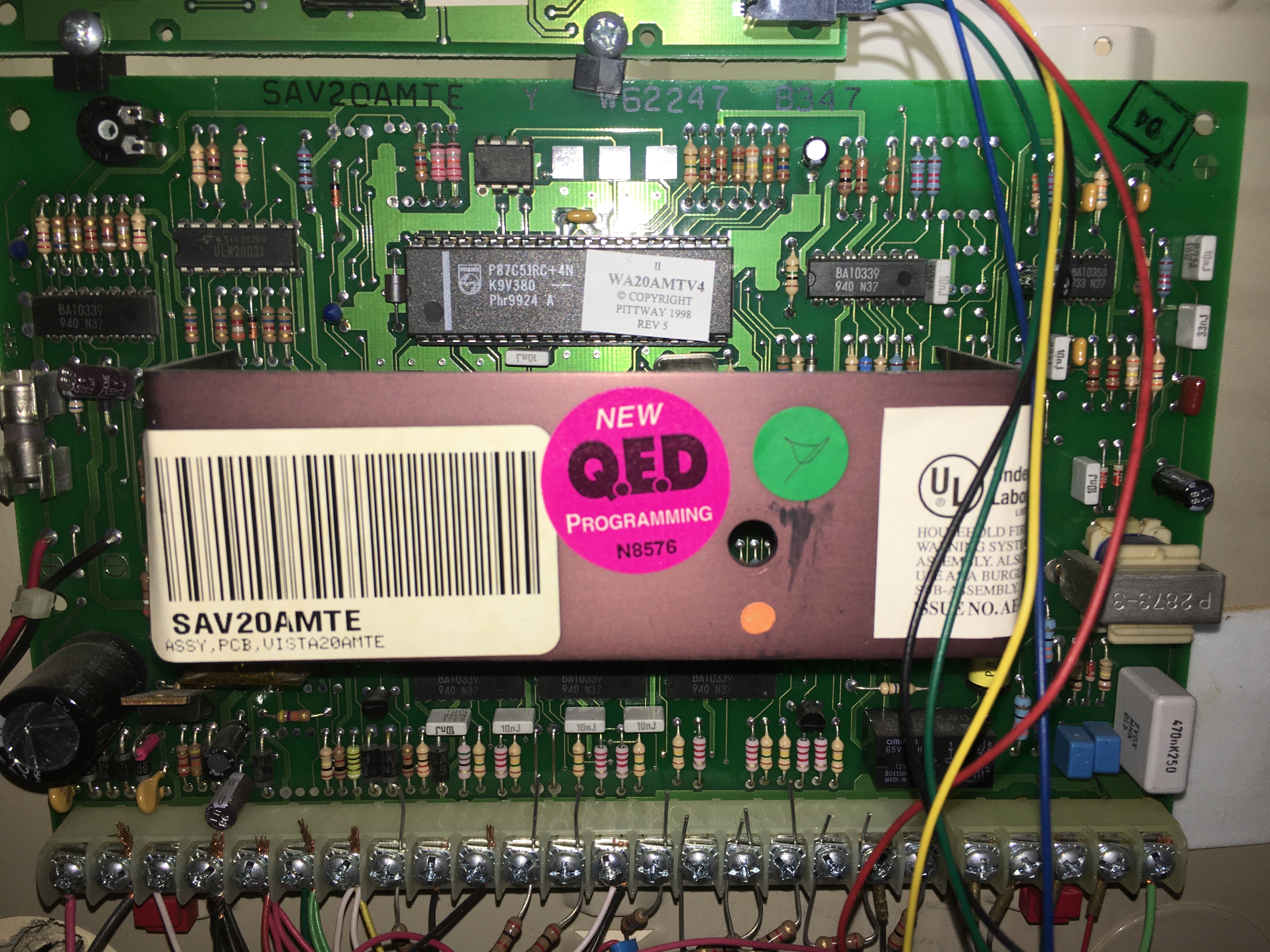

Family member purchased a townhome with an inactive wired Honeywell-based system. The home has three levels and two cabinets housing the alarm equipment. From what I can determine the original system employed a SA5882-2L/SAV20AMTE system and later a SA5882-4/SAVS20P3 system which appears as a ‘takeover’ connected to the SAV20AMTE.
What if any components can be used in a Surety/ADC monitoring arrangement? The number of monitored zones appear as less than 10 (8 from what I can remember.) The system includes window, door, motion, and smoke sensors.
Open to using (any) existing components or starting from scratch if that makes more sense. I did take photos of the PCBs and operation panels, which I presume will be useful as the discussion continues.

To better assist, posting pictures of the boards, especially any stickers on the boards, is always helpful.

So four pics follow; I’ve more but want to be mindful of the space taken. You may delete them from the community space once you view this reply.
Oldest/original board:
I think you’re right. It looks like the older panel is a proprietary Honeywell Vista 20, maybe from SecurityLink? Then later it was taken over by ADT. They added at least one keypad or touch panel and maybe some wireless sensors.
It looks like there are 6 wired zones on the old panel and no wired zones on the new panel. Do you know where all the sensors are? Can you tell which sensors are wired and which are wireless? Is there a zone list in the inside cover of one of those cabinets?
The easiest thing to do would be to replace it with a system that’s easier to work with. The newer panel is still 16 years old and that’s a kind of complicated setup.
If you just have a bunch of wireless sensors that you want to reuse then you can get the Honeywell compatible IQ Panel.
This my option if u know anything about the system like sensors or what have u use the take over but if not sure it might be best to just get a whole new system so u know what’s what
