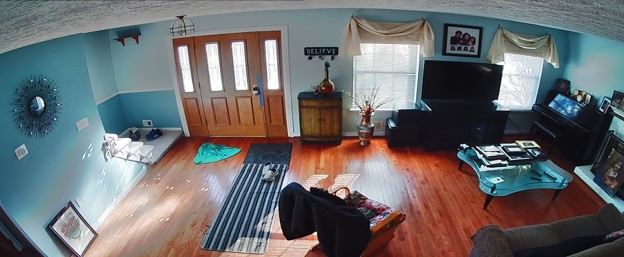

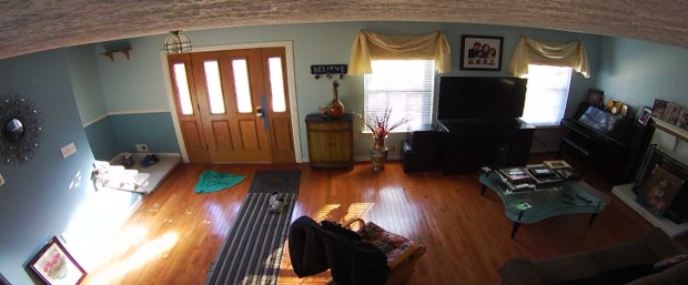

HDR comparison
Without HDR With HDR
ADC-V722W: 88º field of view, no HDR ADC-V723/723X: 117º field of view, HDR
ADC-V522IR: No HDR ADC-V523/523X : HDR
