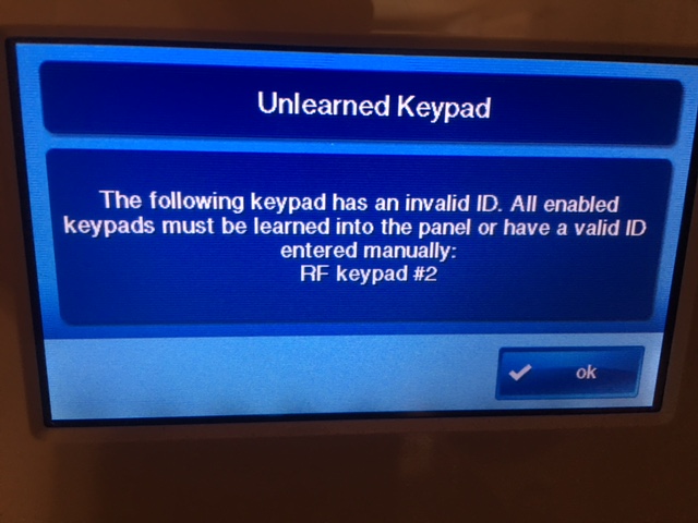

here is my error.
The Following keypad has an invalid ID. All enabled keypads must be learned into the panel OR have a valid ID Entered Manually: RF Keypad #2
A few things:
The Repeater does not need to be learned in to repeat the signals. In order to boost the signals of your sensors, it only needs to be powered on. To use supervision, low battery etc. for the repeater, learning it in is needed.
It wouldn’t affect keypad programming when learning in the sensor. That error is referring to a wireless keypad programming. Did you try to learn in a keypad at the same time?
If you couldn’t save any of the programming, try going back in and following the video, make sure you do not access any other section of programming past the sensor and just save and exit, do you still see this error?
2. It wouldn’t affect keypad programming when learning in the sensor. That error is referring to a wireless keypad programming. Did you try to learn in a keypad at the same time?
I think maybe when I did the Firmware update months ago The CP2 needs to be relearned to the TS1? How do I do this. Im looking online.
Im totally confused now… Im getting the same message with the new Image sensor from Ebay.
I figured it out. I had a keypad#2 in the main panel that was not fully configured that I deleted. All is well. I got the sensor and repeated working.

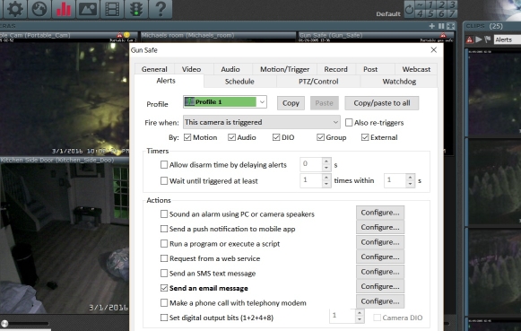

here is a screen shot of some of the options BlueIris has. I highly recommend this software. Its got TONs of featured Push notifications SMS Email and many more.

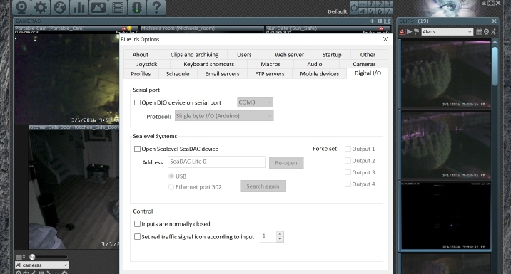

here is a screen shot of the BI software page
Foscam has a variety of models. It looks like the WVC54GCA does not have input/output capability.
If you do have a cam with I/O leads or terminals, generally you can use a wired sensor contact to generate recordings, etc. with settings in camera UI.
