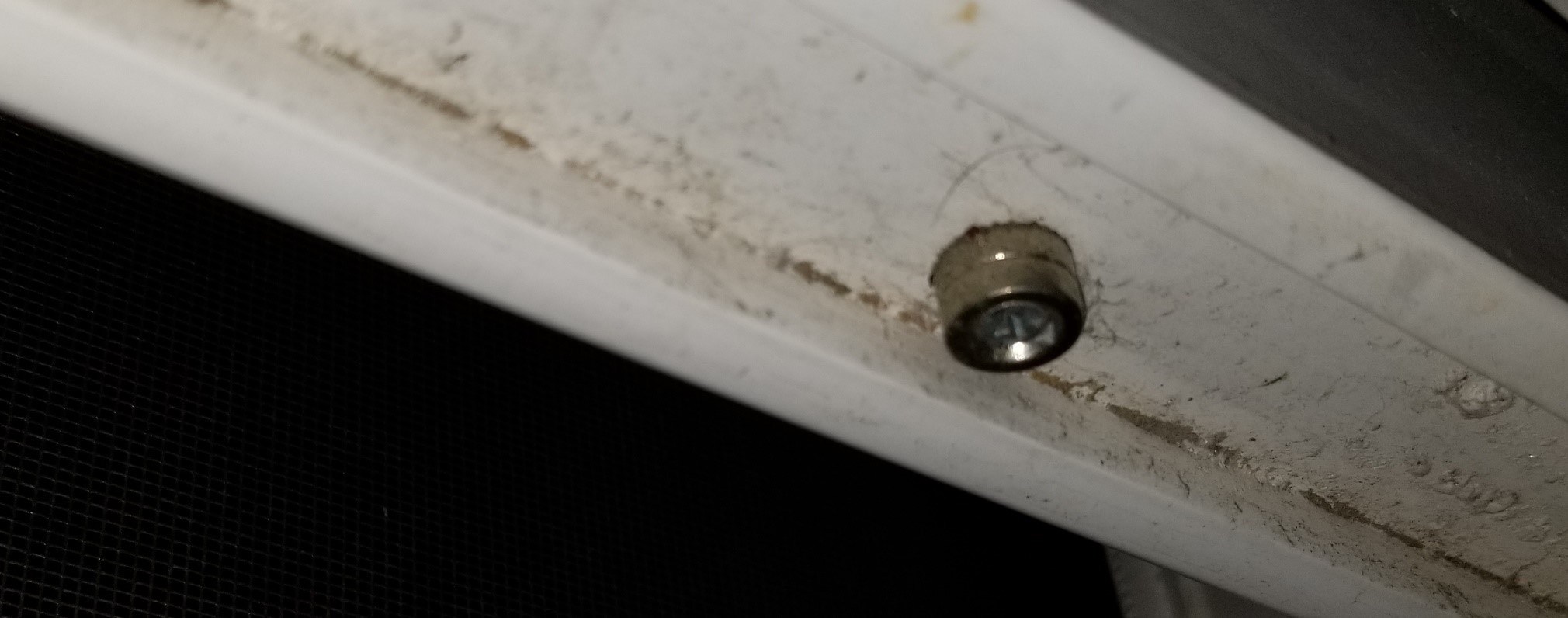

Thanks Warren. When you say surface contact, do you mean like the one I’ve attached that’s currently on the sliding door? I’m worried the gap may be large enough that a flush mount magnet might not close the circuit consistently.
If that’s what you’re referring to, is there a surface contact magnet you recommend?
I mean a contact like the S-Line Mini DW. This is mounted to the surface of the door and frame, not the inside track like what appears to be in the photo.
Oh I see. I have some of those. I’m thinking my wife may want them to be hidden, but I’ll leave the option of the mini D/W mounted to the surface of the door and frame as an option.
As far as magnets go, will any suffice if I do decide to use the recessed sensor in the track?
The recessed wireless sensor comes with the magnet that should be used.
