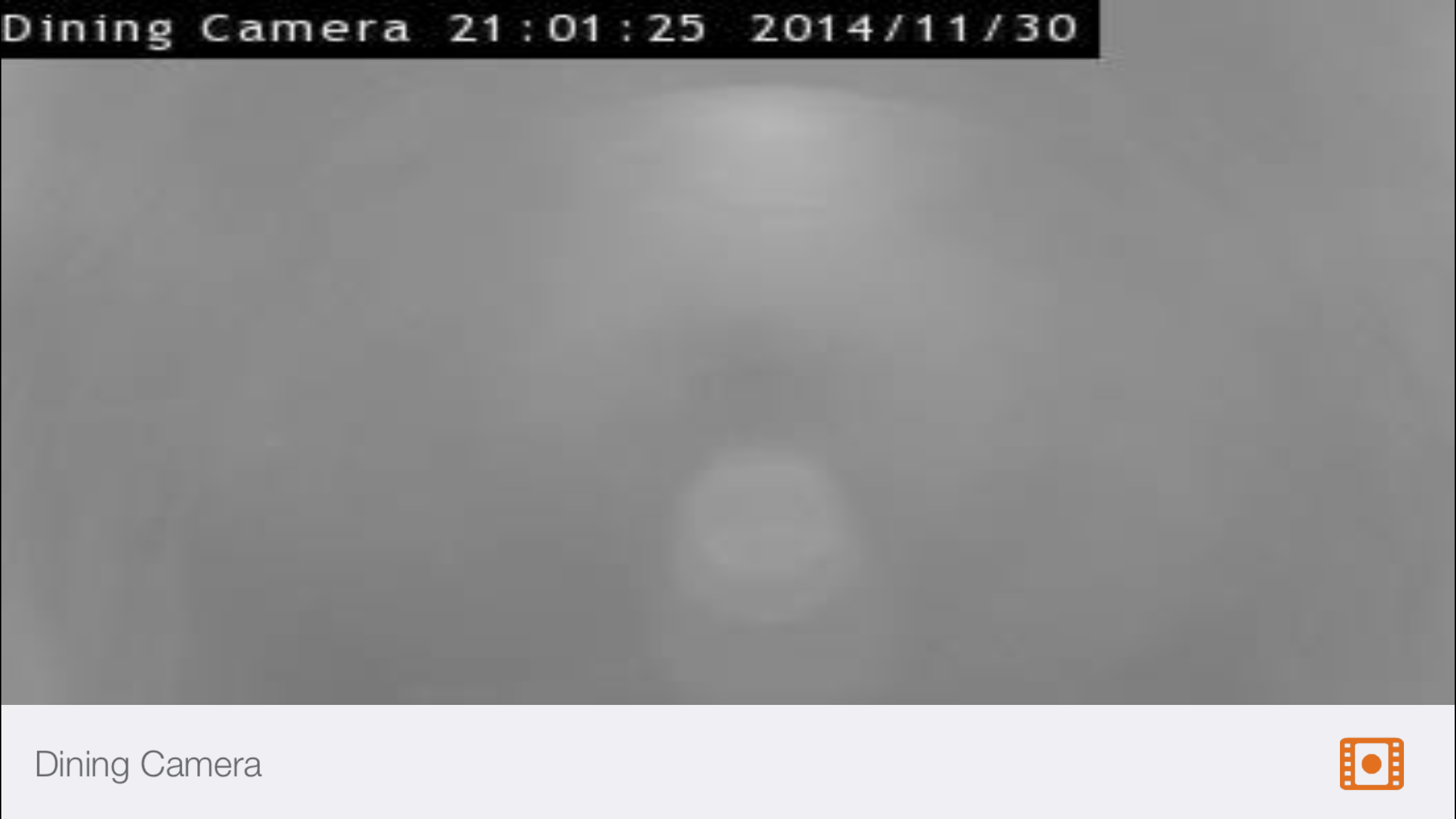

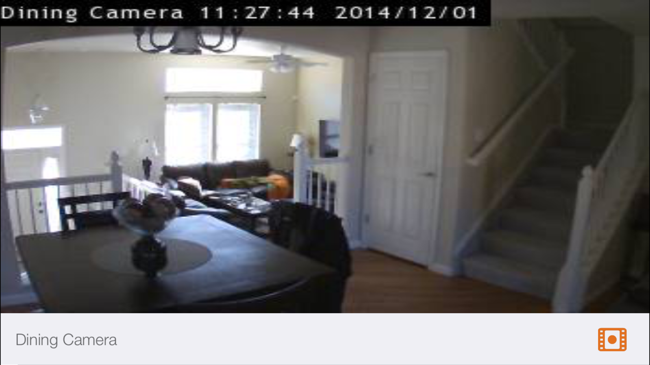

I have a new Qolsys panel up and running now, but I don’t believe that my HD100 cam is working properly. In normal light, the picture is fine. When the IR is on, I can’t see anything at all. If I walk near the camera when IR is on, it doesn’t pick me up until I’m about 2 feet away from it.

Can you attach screenshots of what it looks like in normal light and when the IR light is on?

Screen shots attached.

I’m having the exact same issue. HD100 camera works perfect in regular lighting but with the night vision it is completely blurry and cloudy. This is a brand new unit right out of the box. Exchanged it since I figured the camera must be defective because my original HD100 purchased over a year ago works perfectly. I received new unit last week and this new one has the exact same IR night vision issue. The chances of two brand new HD100 cameras having the exact same issue? I figured I’d check here as I’m thinking this might be a software issue instead… Lo and behold I see a post here with someone else having the exact same issue. Any thoughts on a fix?? I’d hate to send this one back and get a third unit with the same problem again… I’d include a screenshot but it is identical to the one posted above.
