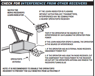

Also when I first plug in the units, the red led on the MDRU blinks and does this for a long long long time. The instructions seem to indicate that when you plug it in, it will be “off” and you pres the button to light it up to learn.

I am not immediately certain without experience using that (we’ve never carried the MDRU) but I would imagine two shouldn’t be the problem. Have you tested to see if the overhead receiver is causing it? Unplug the overhead while the MDRU light is flashing and see if it goes away.
