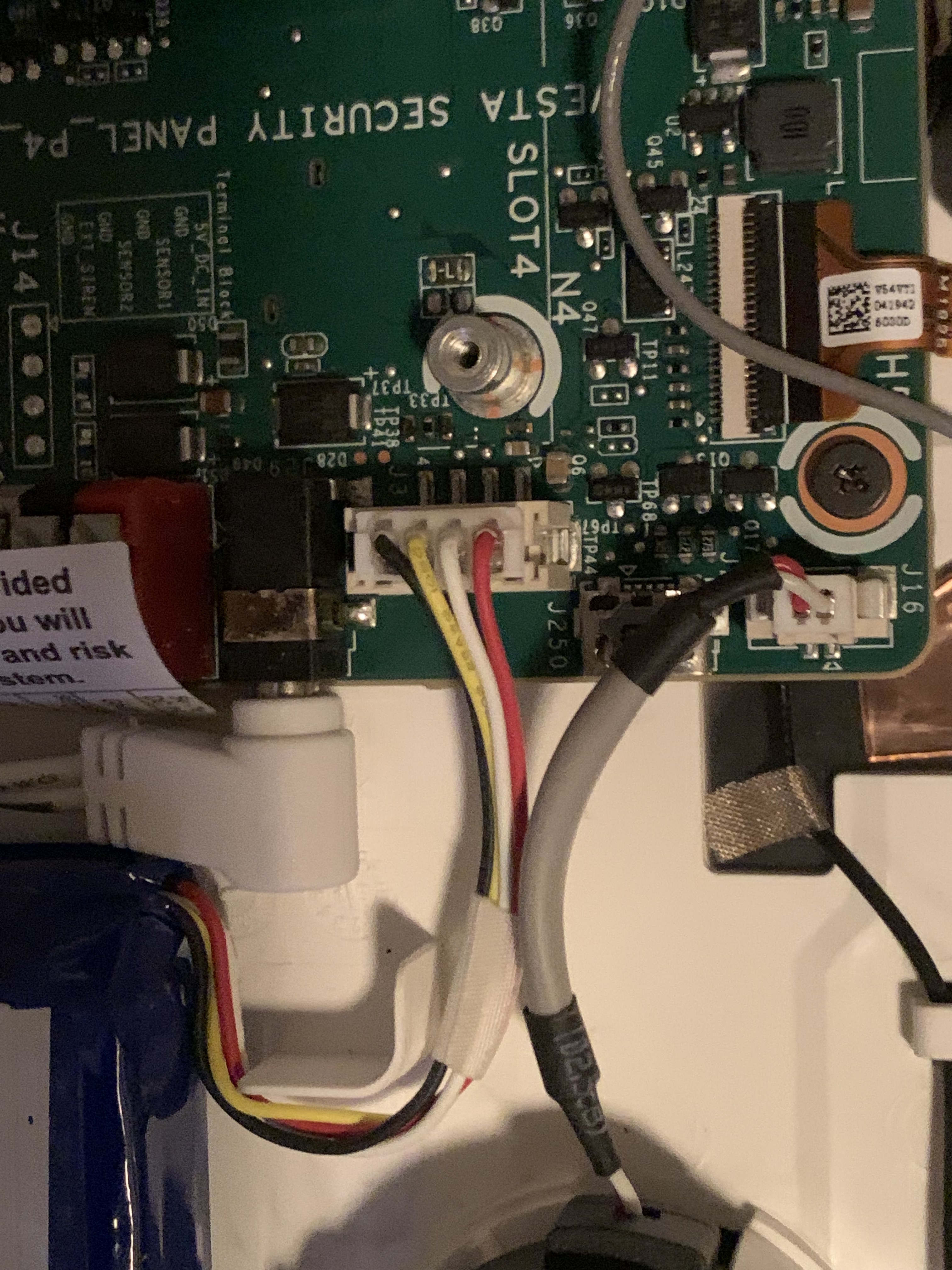

Ok…so my screen is hosed now…I can’t press buttons accurately
1: are the screens tied to the boards from a security stand point…like iOS devices. I’m planning to purchase a used device and swap screens by removing the existing hardware and swapping them over.
2: hopefully it’s not the board side of things…but I guess I’m going to find out
3: For the mean time can the device be remotely updated?
The screen is not meant to be replaced. It is unclear of the issue is screen related, or another piece or hardware is at play.
Panel is reporting FW 2.8.1 which is up to date. If purchasing a replacement panel, a backup can be run if needed, so long as the panel is still communicating.
I know things aren’t “meant” to be replaced but I’m going to mess with it at this point…not much to loose…so I’ll be a tester and report back on my results. Looking to pickup a used panel and try things out. I’ve had luck with some tv repairs in the past, so…if I fail, then I’ll buy a new iq4.
