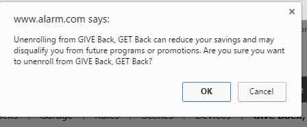

I’ve had to turn off the Give back, Get back on my Alarm.com account 3 times now after my thermostat has been adjusted without my consent. Why is this happening? I turn it off, it warns me of the eco impact, I hit OK. I check the settings again, and it’s back on without my interaction. Can Alarm.com reimburse me for my thermostat drifting and it taking hours to bring my house back down to the desired temperature at my financial expense?
