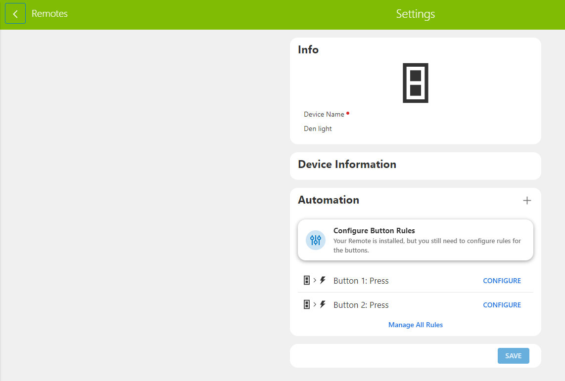

Sorry to bring this thread back up, but I think I found something new. I have had to replace a few of these GE Enbrighten switches now. Under the automation tab on ADC they now show as configurable remotes unlike the previous switches I have had. Is there a setting on the GC3 that is causing this?
Remotes is a relatively new feature through Alarm.com for Z-Wave devices that act as remotes.
Are you able to use this device as intended?
