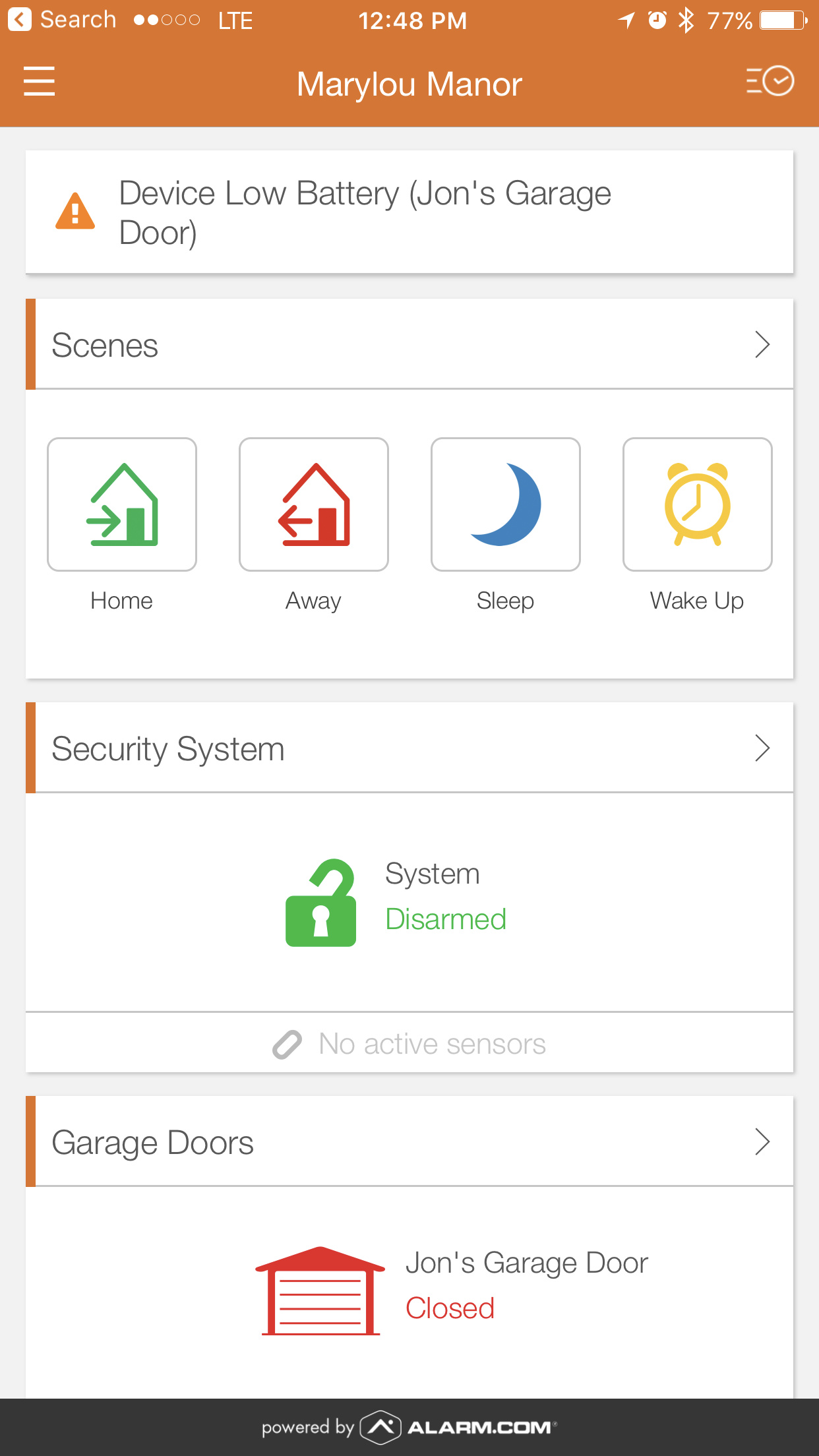

You can’t control from the GC3, but it works in alarm.com and should show up under emPower in garage door. Here’s a link from my own home that shows the garage and a low battery report just fired off this AM. I’m not in front of one, but I believe it does say unknown device as you mention on the GC3.

I see a Z-wave garage door showing on your account. Are you not able to access it? You may need to log out and log back into Alarm.com.
