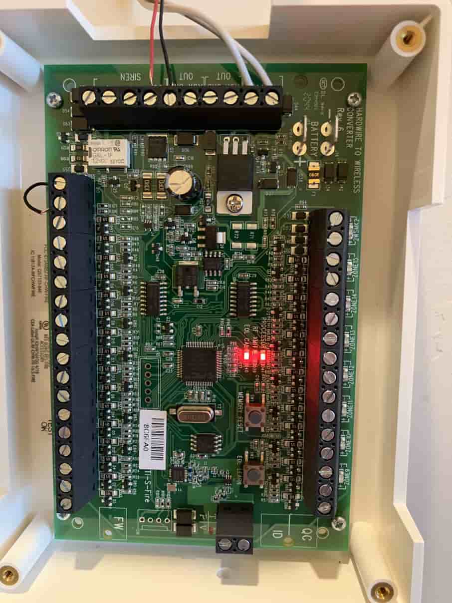

I Purchased an IQ 16-F Hard wire panel and trying to connect the siren .
It seems that I successfully paired the 16-F to the IQ4, but it does not show the wired siren as a zone or sensor.
The red is the wire to siren and black the ground, the wires go directly to the outside siren.

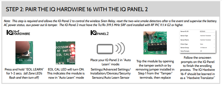

As long as the Hardwire 16F is included as a zone on the panel for supervision, the panel should wirelessly activate the siren output on the Hardwire 16F
Since I only have the siren wired, pulling the ground from the siren would be my “Trip”, correct?
I have done this several times and I fail to get the onscreen prompts?
The Siren Tamper relay was run through the TAKE 345, so disconnect the siren tamper relay and remove it from the IQ4 345 MHz. Then wire the tamper relay to the IQ4 “TAMPER” Terminal.
The pairing of the IQ Hardwire 16F to the panel has nothing to do with the siren.
You use the tamper terminals on the IQ Hardwire 16F and just use a jumper between them if you do not have them connected to a tamper switch. For the vast majority of installations there is no tamper switch on the old panel housing, so you would just use a jumper (a short section of wire)
So I just realized, looking at your account you’ve used a 345Mhz IQ Panel 4.
The Hardwire 16F only works with the 319.5 Mhz version of the panel.
