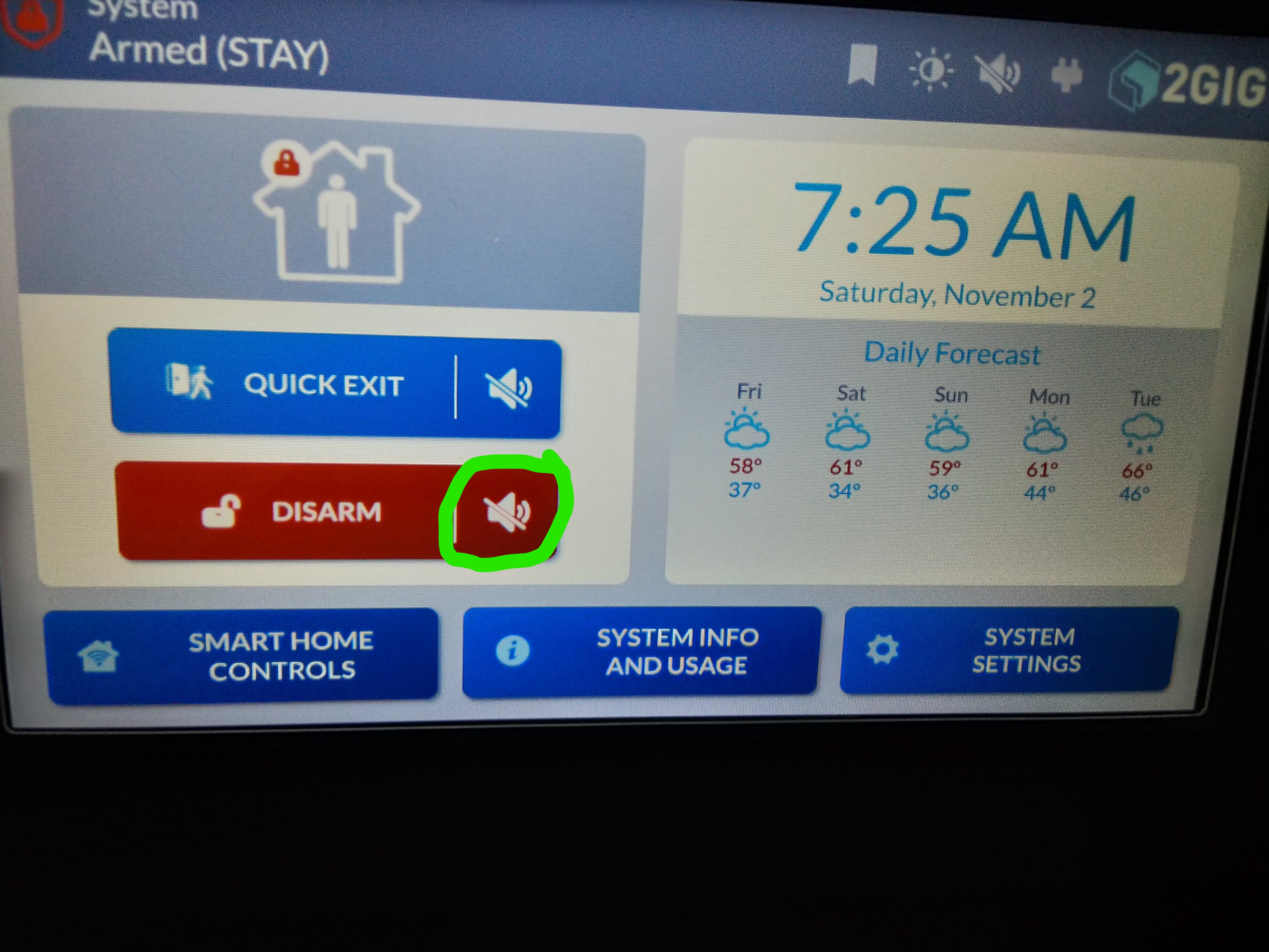

Made this discovery. There is a silent exit option in the GC3. Just click on the muted speaker symbol when disarming on the panel.
Yes, if you are always disarming locally at the panel screen for this, you can tap the silent arm/disarm in order to disarm quietly. Apologies I thought that was referred to in an earlier post above regarding silent exit.
There is no overall setting to make this the default, it would just need to be pressed each time, and it wouldn’t work remotely.
