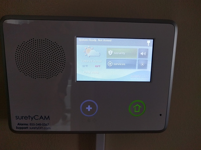

Hi,
I noticed this morning that the screen on my GC2 panel looks “washed out” (i.e. has very poor contrast). The panel works/touch screen is responsive, just the contrast is very low (see attached).
In oder to remedy the problem I’ve tried
  • Changing the screen brightness setting. -- The screen gets dimmer/brighter as I adjust the setting, but the contrast remains poor.
  • Doing a dummy configuration change to force the panel to reboot. -- No change either.

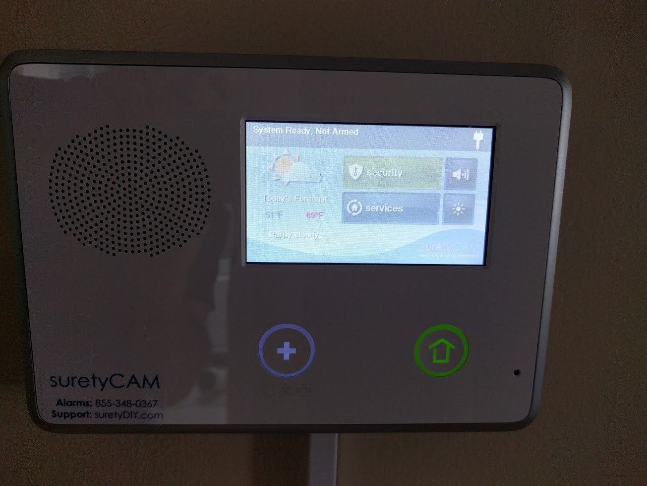

I’ve attached pictures of the GC2 panel that has the problem and (for comparison) another picture of my TS1, which is fine.
I installed the system about 15 months ago. The panel is running firmware version 1.14.0.2_PRODUCTION_EN_US.
My suspicion at this point is that this is some kind of hardware failure and I either might have to live with it or replace the panel, but if someone has any ideas on how to remedy the situation, any hints would be appreciated.

That does look like a hardware cause. Something to try would be to power down the panel completely, transformer first, then battery, and leave the panel powered down for two minutes. Then power back up, battery first, then transformer.
Any change?

One more thing, I believe the display ribbon is near the center of the GC2 model there. Do you notice any visible damage? If you open and power down the 2GIG Panel again, try applying a little pressure to the display ribbon connection. Press for a short bit, then power back up. Any luck?
You may also want to try a firmware update since you do not have the latest version, as a hail mary. If the display ribbon pressure doesn’t work, we can initiate an OTA firmware update (looks like this account has a Go!Bridge, so the update is free)

Thanks! – I already checked the ribbon cable and made sure it is seated well when I had the panel open and disconnected the battery, so I think we can cross that one off the list.

The panel just completed the update to 1.17. TS1 still seems to be updating. – While it was worth giving it a shot, the screen still looks washed out. :frowning:
