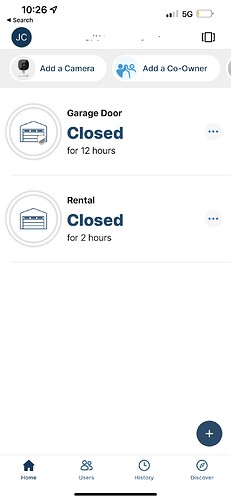

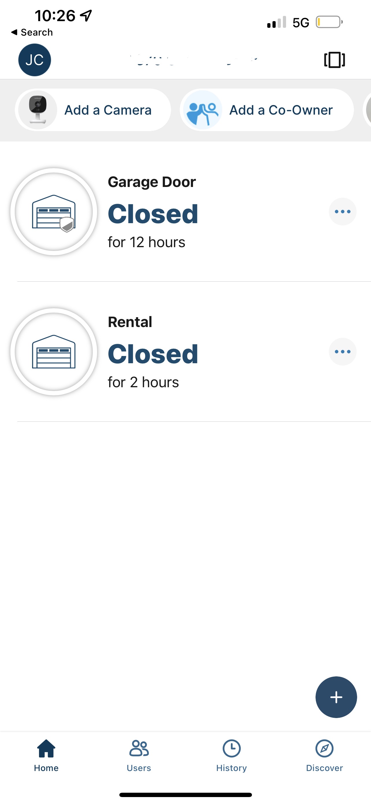

Mind sending a screenshot of the MyQ app?
The one with the shield logo on it is the ADC hub serial I registered. The other is just a smart hub I added to MyQ but once added it shows in ADC.
Very interesting, there isn’t an account history event for the second door addition like there is with the first. The second door shows as having been added 8/29 but without an event recorded.
I’ll see if ADC is working on the integration and just hasn’t posted docs yet.
