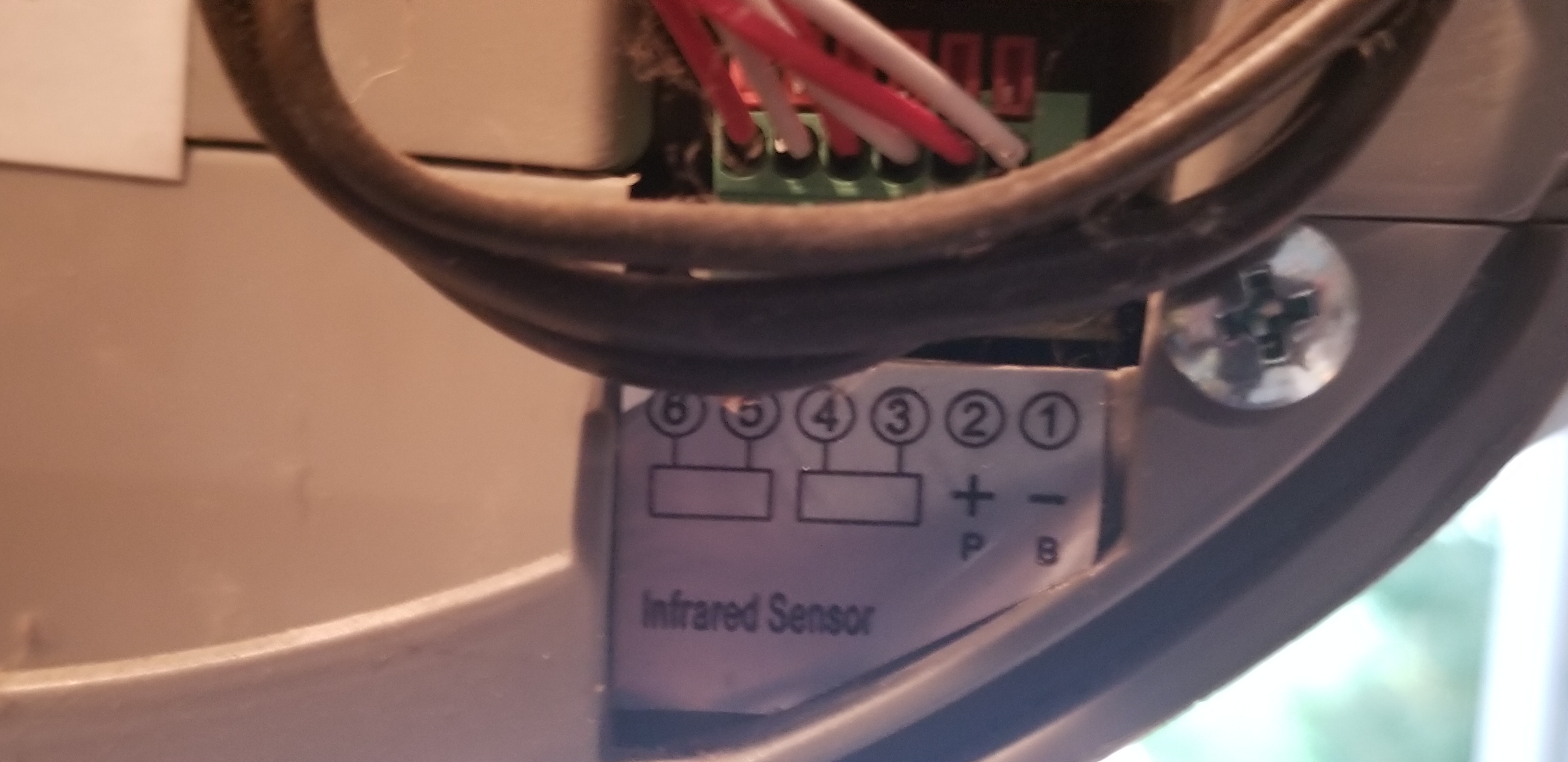

You stated that Liftmaster/Chamberlain MyQ openers are not z-wave but are compatible with my panel and can be easily integrated? Is there any disadvantages using these alternatives that are wifi instead of the one zwave option? Do you have any reccomendations? My learn button color and opener brand is on pic attachment.

According to the MyQ compatibility document for the universal hubs, yes that model of Overhead Door (1026) would be compatible.
You would want one of the universal overhead hubs like the MyQ-g0201.
This can be integrated with any suretyDIY account using Gold Automation. The MyQ device is linked through your Alarm.com account and controlled through the Alarm.com app.
It would communicate with ADC via your internet, not the panel.
One disadvantage to these hubs is battery life in the tilt sensor which tells the hub the position of the door. Generally you should replace this battery yearly to avoid issues.
