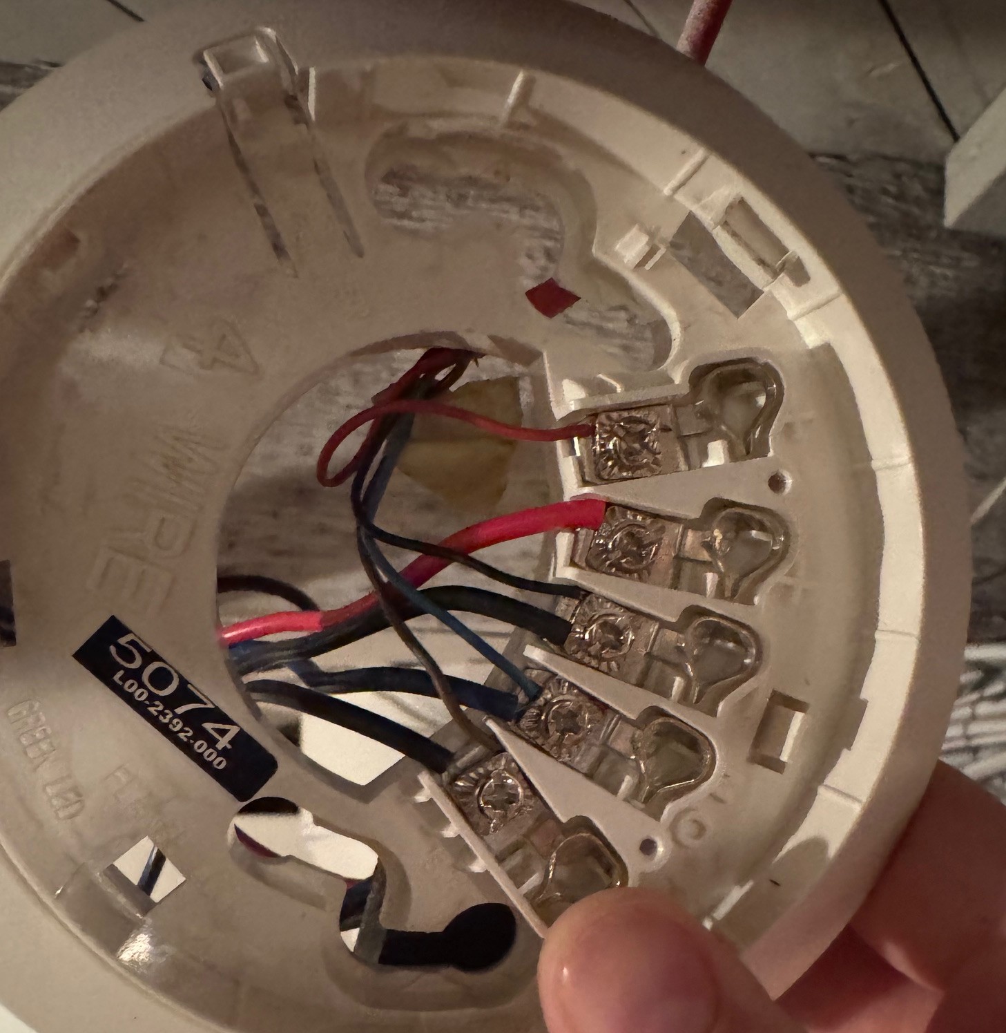

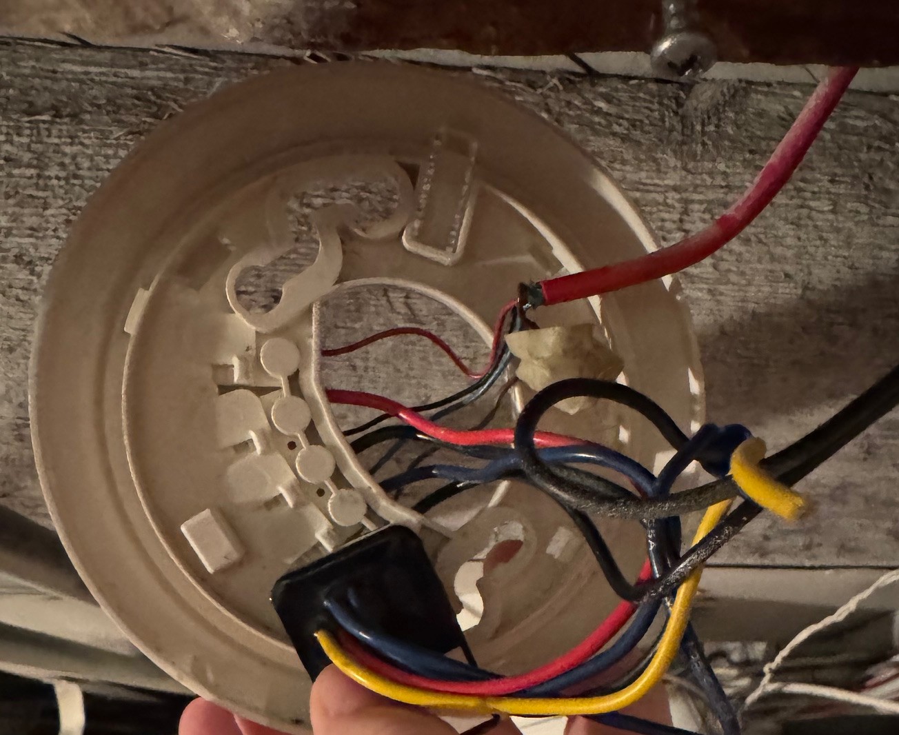

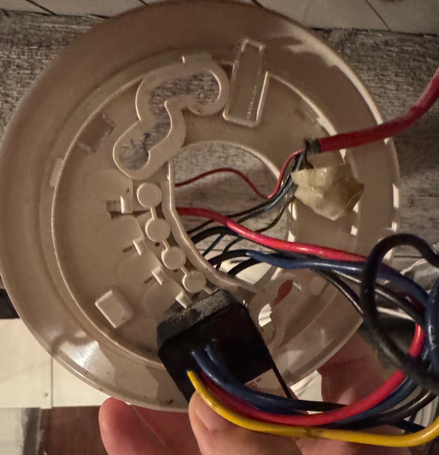

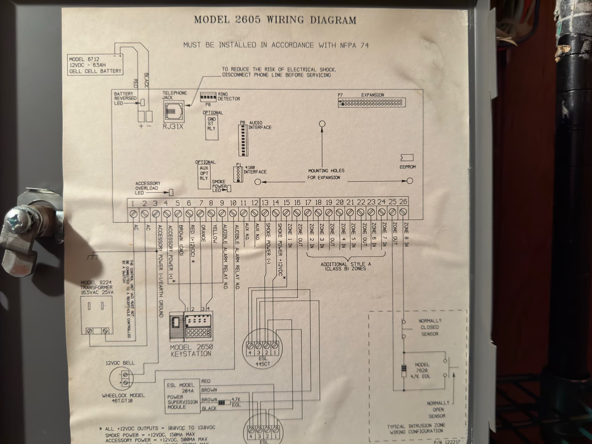

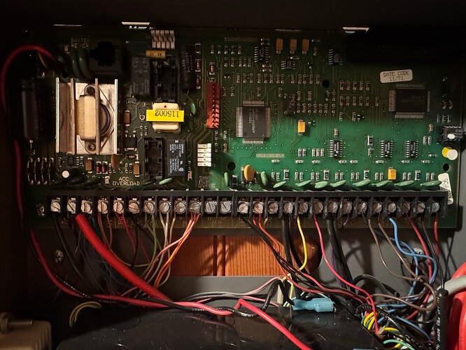

The IQ Pro replaced an Silent Knight 2605 hardwired system w/ System Sensor 4WT-B fire sensors (see pics below). I’ve got all the wires from the old system labeled.

  2. I can swap my existing hardwired smokes (previously wired to 13 and 14 on Silent Knight( to a SINGLE zone (two wires only) on the IQ Pro. The panel will power them using the low voltage panel input. Is this valid? Can I test them by just plugging in and powering up the board? I believe I need at least partial wired smokes in my area but TBD IANAL.

Old system, now disassembled however wires are labeled with old positions.

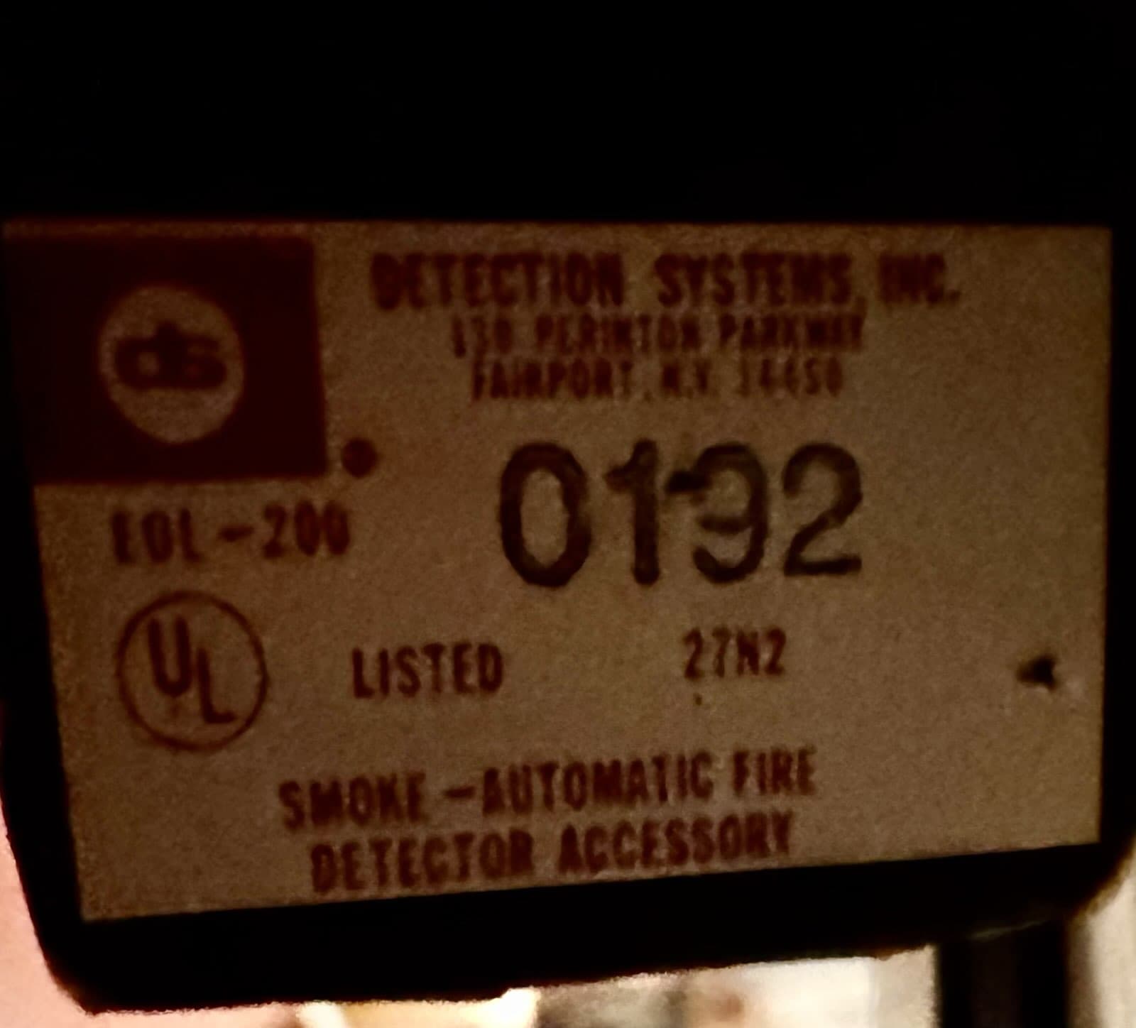

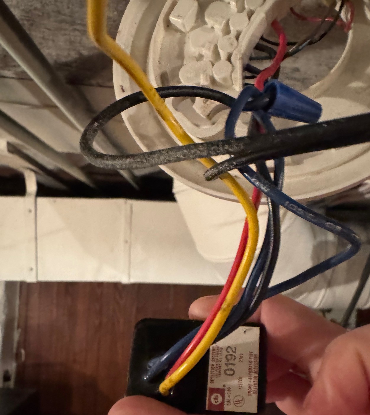

I cannot find the 0192 Detection System manual. Is there another part number on the device? Can you share the wiring of this device?

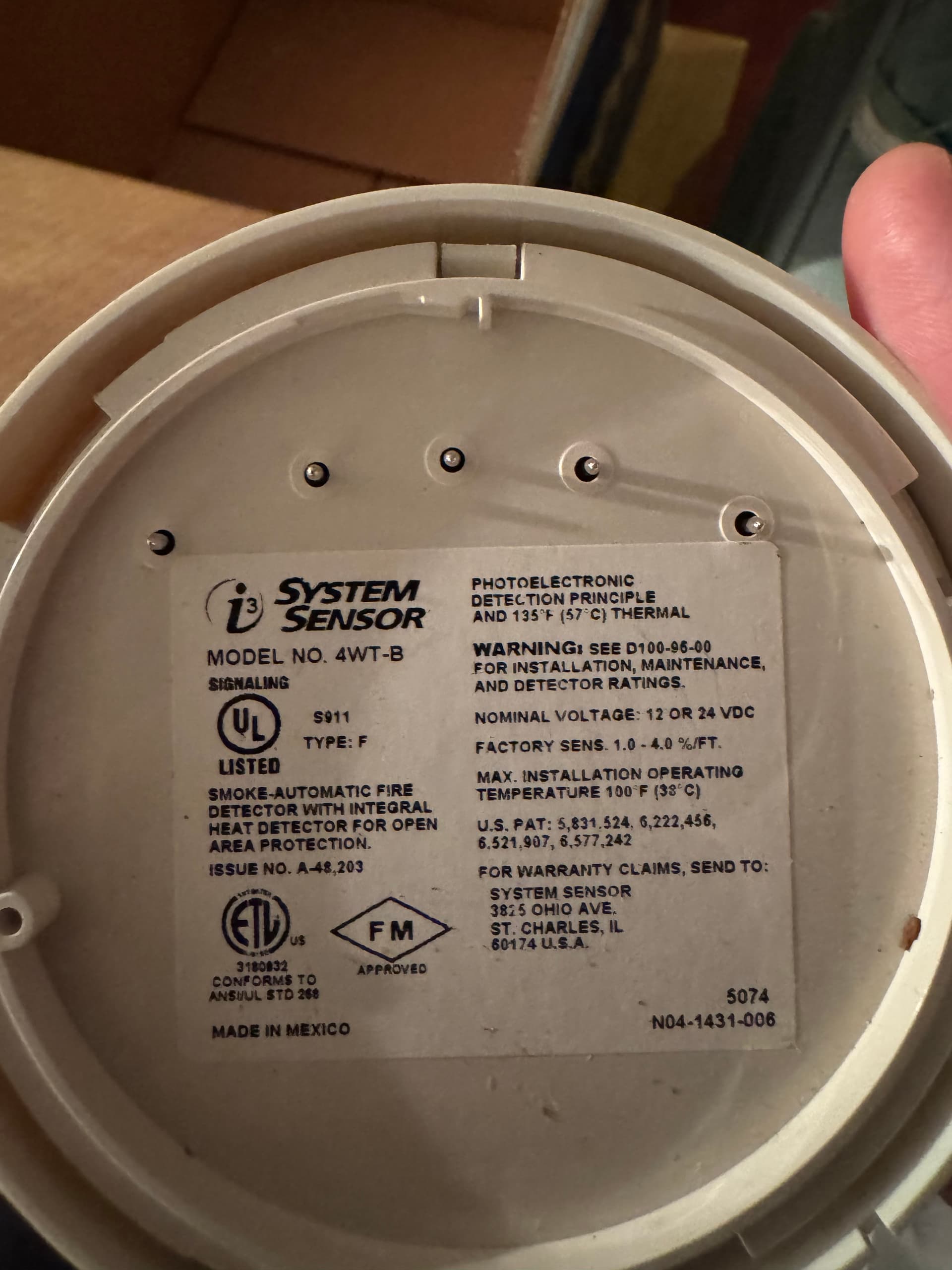

Looking at the picture you sent, 5074 means it was made in the 4th week of July in either 2015 or 2025. Fire devices should be replaces every 10 years.
Detection Systems Inc. (DSI) EOL-200 / “End of Line”-200. Unable to find the manual but see references to it in other documentation.

Looking at the picture you sent, 5074 means it was made in the 4th week of July in either 2015 or 2025. Fire devices should be replaces every 10 years. Does your team have a recommended sensor I can use to replace in kind (with modern tech)? System Sensor 4WTAR-B?

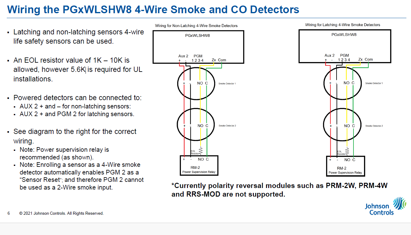

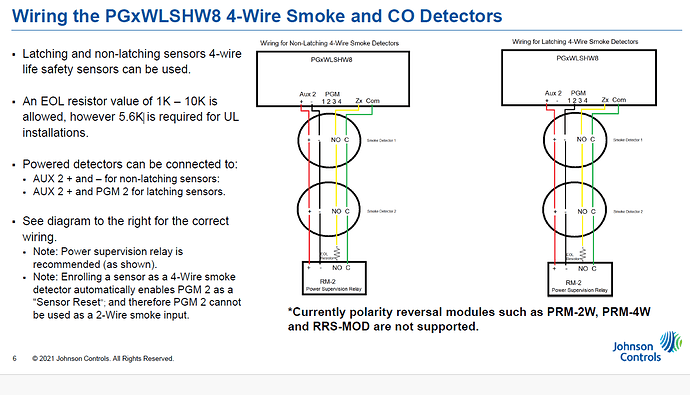

Any guidance on how I chose which resister to use (am I dumb, are they all the same?) Reading this, it looks like I can only use SEOL resistor for Fire, correct?
An RM-2 supervisory relay is recommended incase there is a loss of power on the smoke detectors. For other devices, you can use any resistor between 1-10k however, a 5.6k resistor is needed for UL installations.
Wiring the smokes and RM-2 are in the diagram below.
