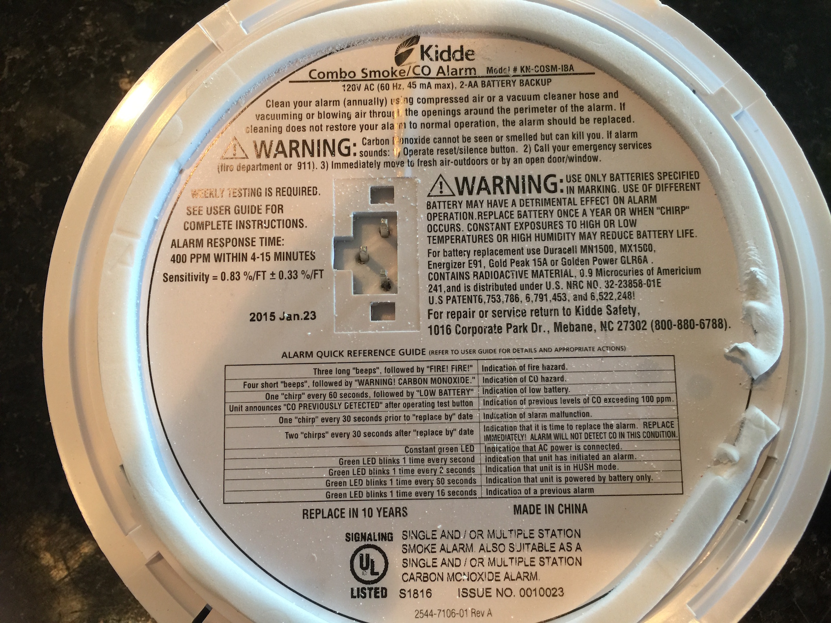

I will have that model tonight. Thanks for the assist.
Sorry for the delay. Here is the Smoke/CO2 detector that we have throughout our house.
Alright, confirmed with 2GIG that either the CO or Fire alarm would set it off, causing a fire alarm at the panel for either one. I wouldn’t recommend using the SDS1-345
Roger, thanks.
