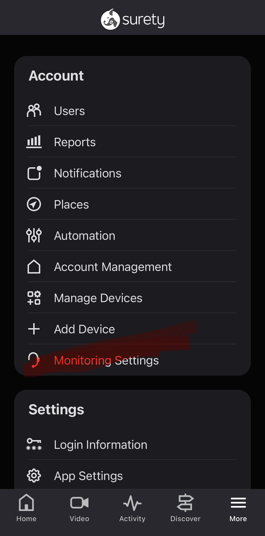

Does your app look anything like this?
Yes, except I am missing the monitoring settings option.

That is interesting. I don’t know what the differences are between the two apps. Do you have more than one login for Alarm.com?
