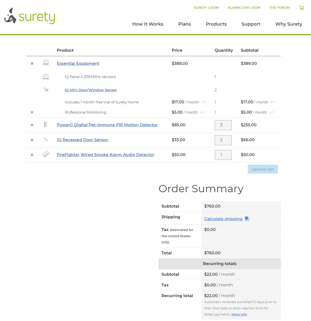

Thank you! Ok, last question, for now :smiley: I am trying to checkout on your site and I don’t see a way to get the Surety Complete service, it’s only giving me surety home. Is that because I picked the “essential equipment” package? I want that package but I want the complete monthly?
I’ve attached a screenshot. Thank you!
That bundle comes with a free month of Surety Home.
You are never locked into a plan though. You can switch to Complete at any time in the system manager after activating your service with the Home plan, and you will only need to pay the pro-rated difference if the monthly service increase from your changes. This ensures you still get the value of the free month of Home.
