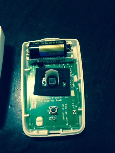

Do you have it on normal sensitivity or high sensitivity? There is a jumper on the circuit board that you use to control that setting. See the picture in the manual.

Hi Ryan, its mounted at a little over 7 foot. This is the 5th location that I mounted it at, at the end of a hallway with really limited sight line, in order to test if it was placement or the detector. The dogs are a cocker spaniel (~30 pounds) and a springer spaniel (< 50 pounds.) The dogs are not really active, and in any case would be far below the detector. There is no heating or AC (Hawaii). Initially I thought maybe hot temperatures were causing the problem but temps have been in low 80s. It false alarms once a day. I think jumper is correctly installed across both pins (see photo). I am currently not using “away” mode and monitoring in “stay” mode. Let me know your thoughts…thanks, David
A sensor tripping that regularly could very well be defective with regard to pet immunity, but is unlikely to be tripping without cause. Out of curiosity, have you done any testing with the dogs? Setting the alarm, waiting five minutes, and then calling the dogs to run through the hallway to verify?
