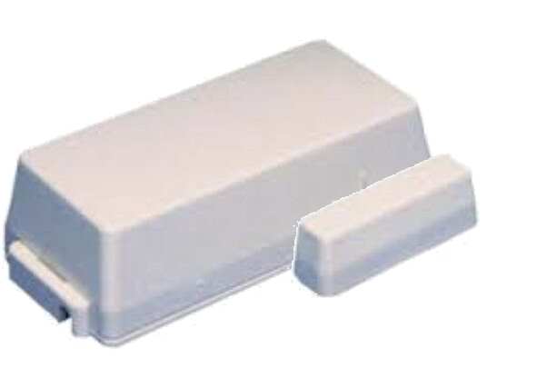

For door sensors there are very few things to consider. It is usually a physical issue with the sensor.
To best help, post a photo of that sensor in a closed position. If the magnet is at the edge of its magnetic gap it is more likely to experience an issue.
What model of sensor is it? If it is a particularly old sensor, you may want to replace it.
Thanks. remote location, can’t access. I always place centered with minimum gap with no offset in door closure depth (or will use a plywood base on magnet if door is inset in frame to get to same height).
Newer sensor, not the older long ones. I believe it’s Interlogix NX-650N 319.5
Sensor set up is approx like this photo., 1/16" to 1/8" minimum gap as possible., aligned perfectly. Screwed in place.
If you are 100% sure the sensor and magnet are in place and as described, I would replace that sensor. There should be nothing short of a faulty reed switch allowing it to open.
