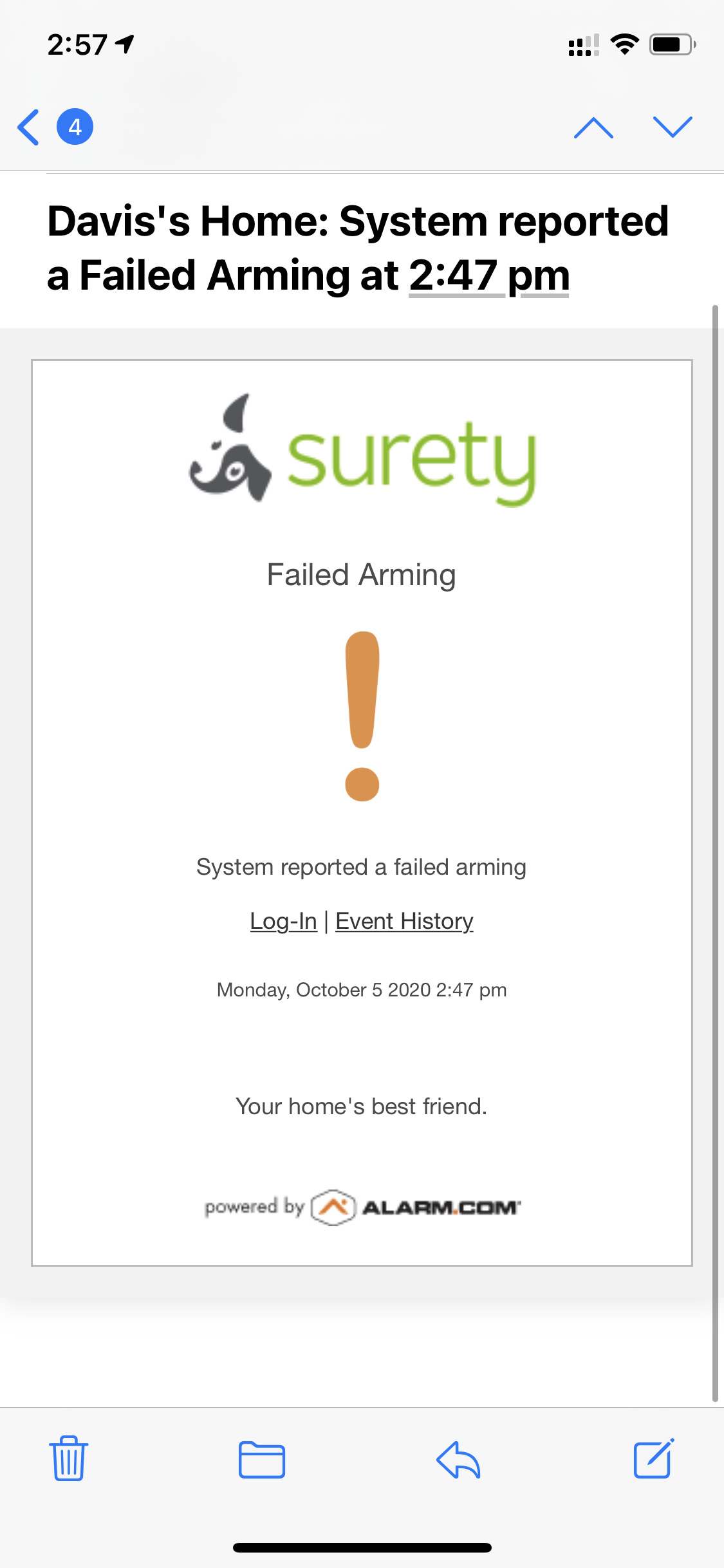

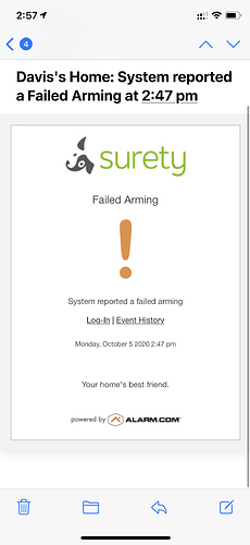

Failed Arming on Door Unlock
When I unlock my front door, even if the system is disarmed, I immediately get a “Failed Arming” message.
So that message is in response to an automation rule you have set up to automatically Disarm the system when two of your locks are unlocked.
