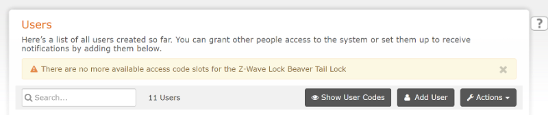

I continue to observe this error. For example see attached. Oddly, the number of lock users needed to trigger the error varies – anywhere from 11 to 15 users. Thanks for continuing to follow up on this!
The number varies on the same lock; but this is over time when tried at various times over a period of weeks. In any case the number is not consistent over time. Thanks Jason!
