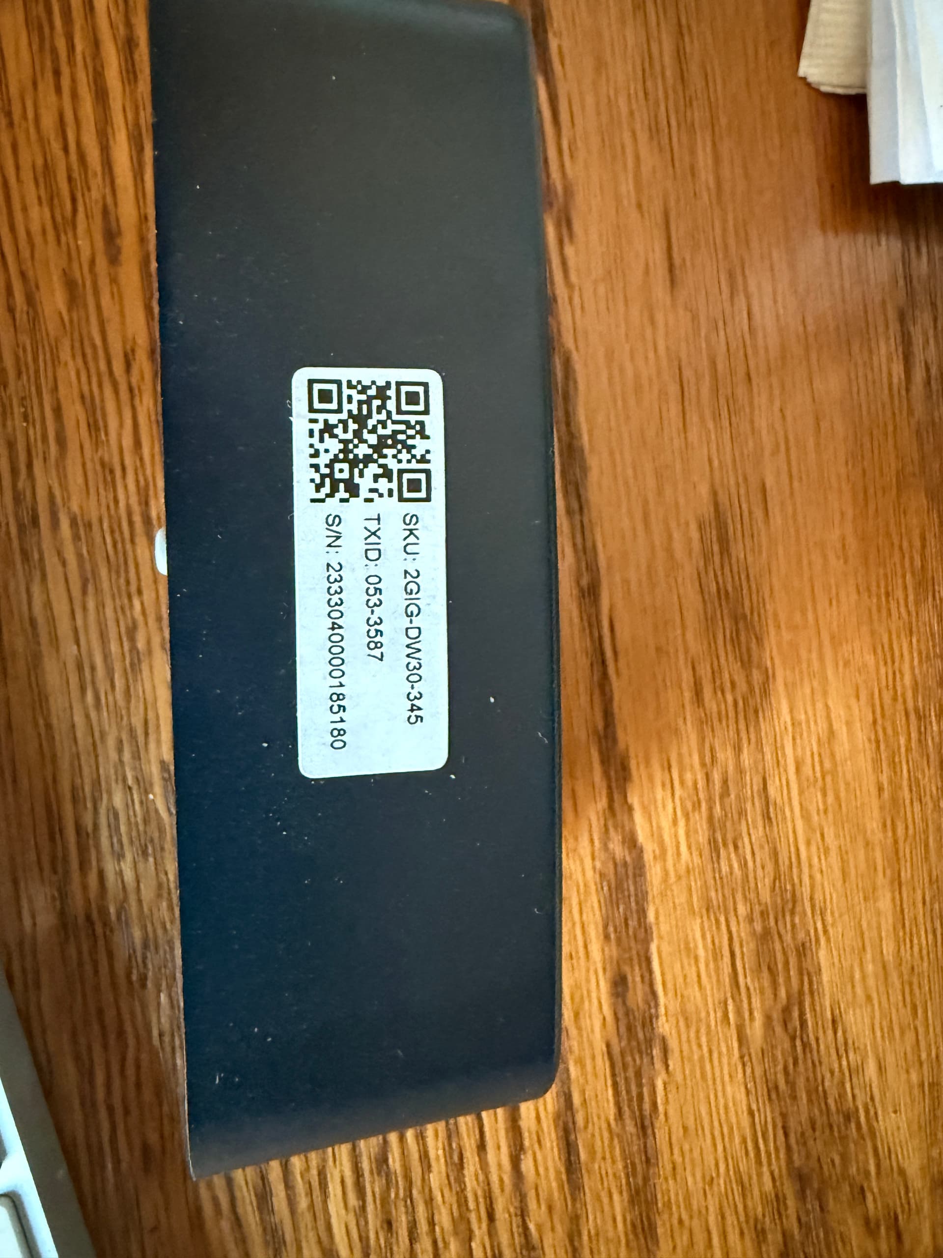

All indications are it is DW30-345, with no e. The only outlier are the instructions that came with the sensor that say the Equip. Code is 2865. I used Equip. Code 0637 with old unit. All other indicators are DW30. The PC board in the new unit is not the same as the old, however it is etched with 2GIG-DW30-345.

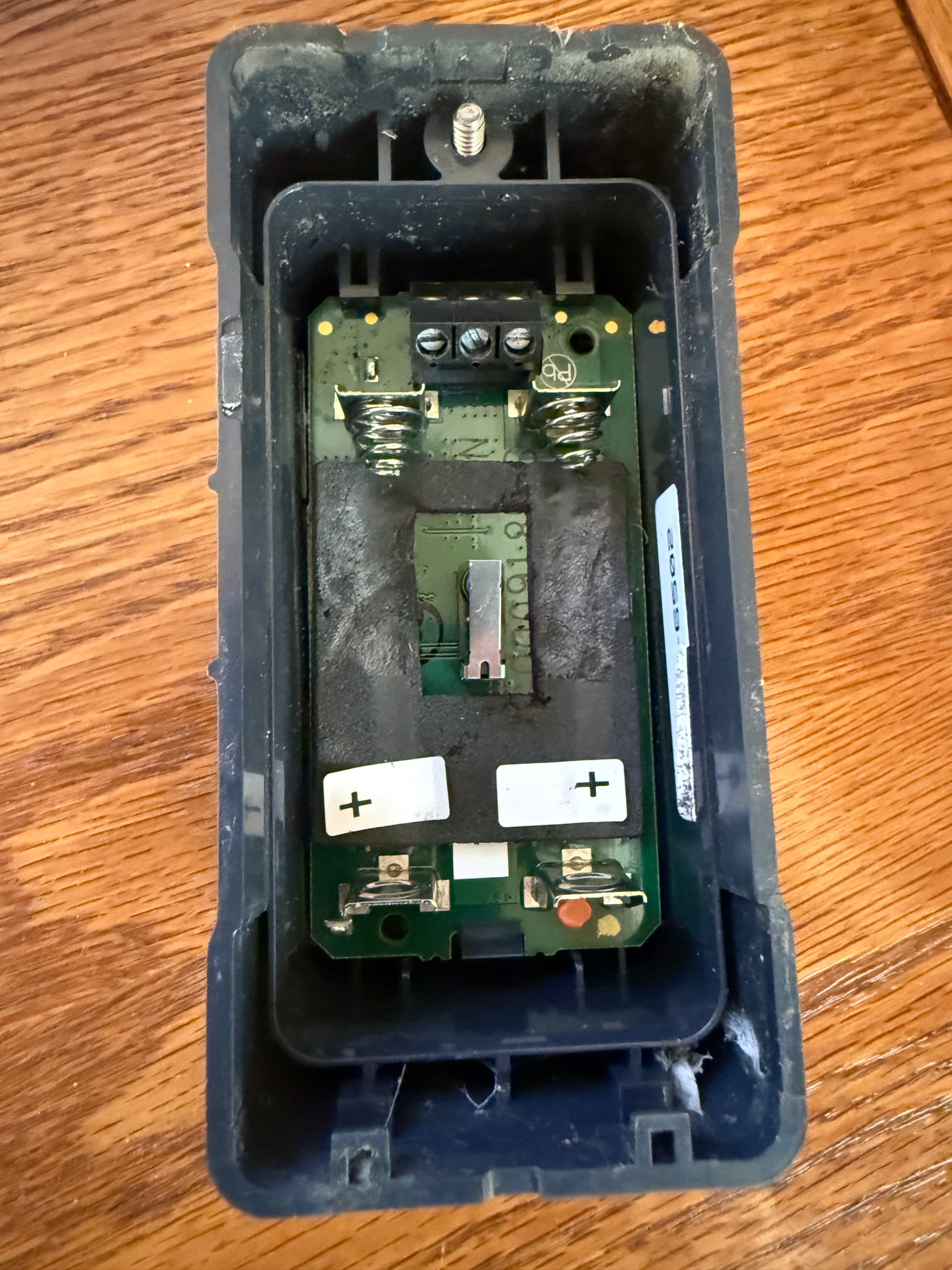

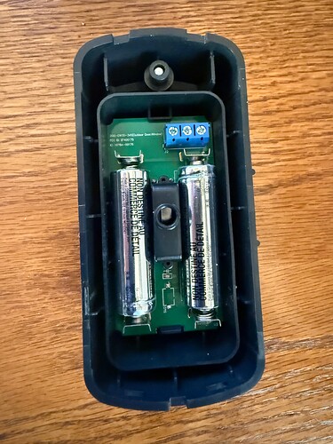

Just a follow up here, as I do have the new DE30 working. I am using it with an external magnetic switch wired to the NC terminals on the three terminal block inside the DW30. I think my issues in testing the unit, which was about 20 feet away from the panel for testing, was not being patient enough to see status changes. It is set for zone type 23 which I suspect may have a lower priority polling rate however I do not know this for a fact. Make sure you use equip. Code 0637 in spite of the instructions that come with the unit saying to use code 2865, which is the proper code for the “e” version. There is a different set of instructions for the “e” version if that works on your panel. I do not know if mine was an isolated case but when mounted flat against my gate post the tamper micro switch was not depressed enough. May need to shim a little with some Scotch 33. Also is you are using external contacts make sure you are using loop 1, loop 2 is for internal reed switch.
