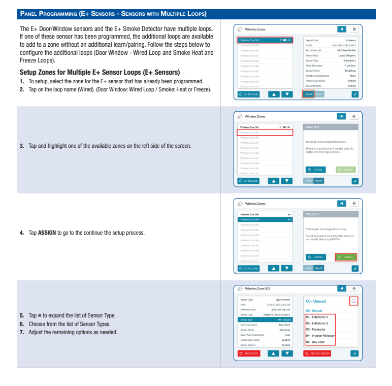

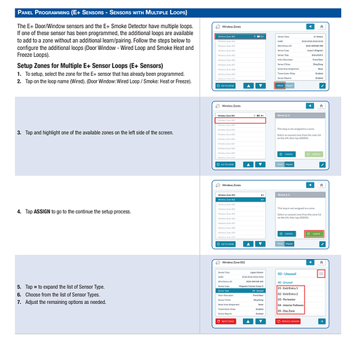

Hello,
There are a few extra steps to learning in an E+ sensor with a different loop.
  1. Learn in the E+ sensor first on loop 2.
  2. Go to edit the zone and press wired on the bottom
  3. You will now need to assign a new zone for this and select assign
  4. Finish programming the settings of the sensor
  5. You can now go back and delete the first zone learned in as a magnet
