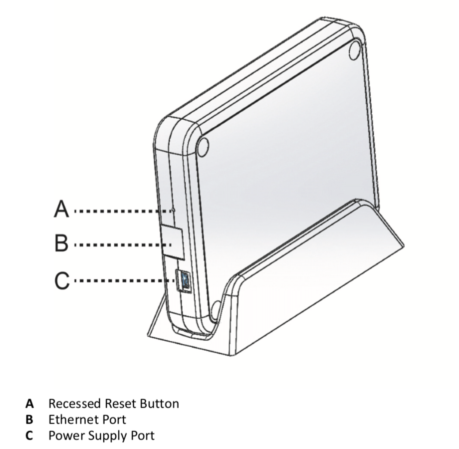

The blinking green light indicates that its trying to find an ip address but cant. On my router page the go bridge doesnt show up anywhere when I try to search it by MAC address?

If the Go!Bridge is powering up but having trouble connecting to the Router, the main likely culprits would be the ethernet cable or the router.
Make sure that the ethernet cable is plugged in firmly at both the Go!Bridge and Router end. Make sure the plastic latch on the connector is not broken causing a loose connection. It might be good to try a known working cable and swap them out if possible.
