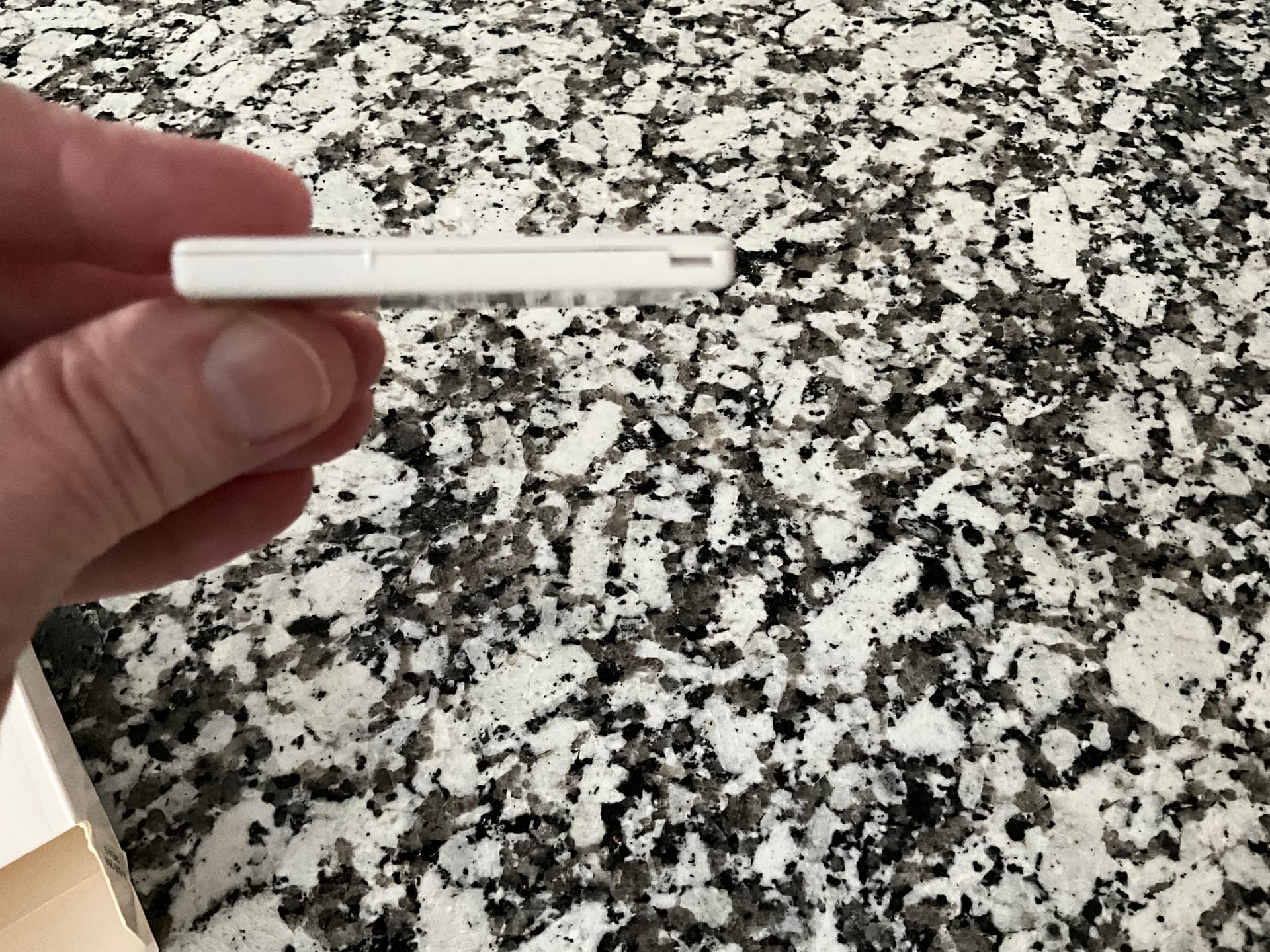

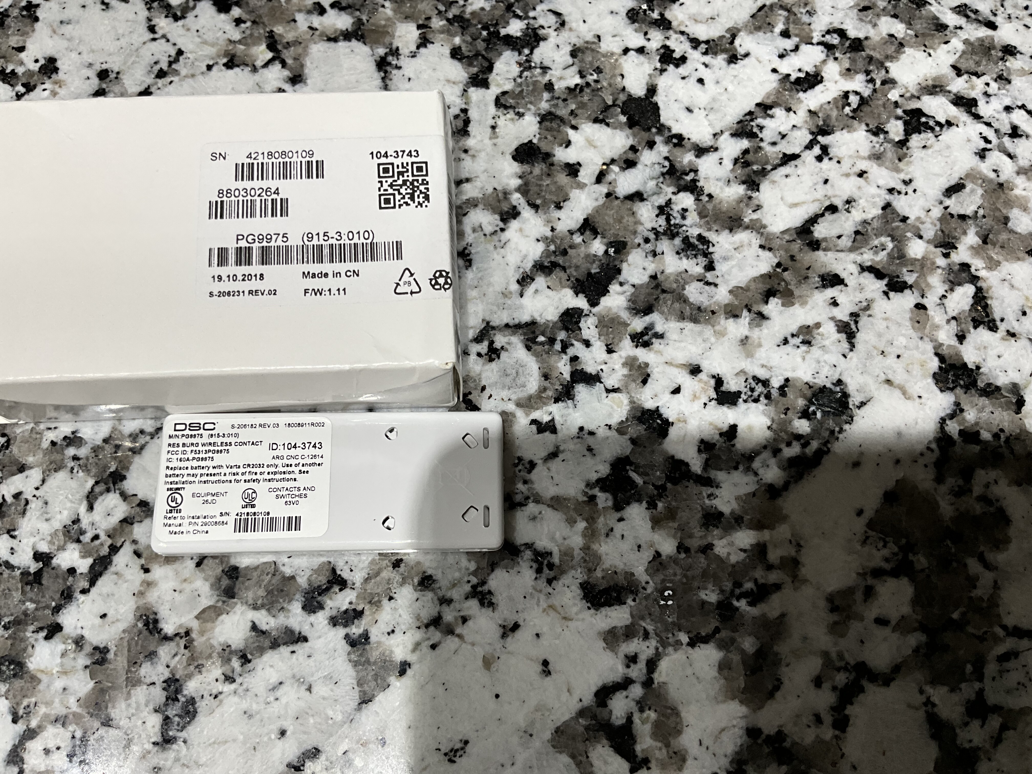

The PG9975 is compatible, but there are some potential issues with units designed for specific systems/dealers. Can you provide a photo of the full part label for those sensors, and box labels?

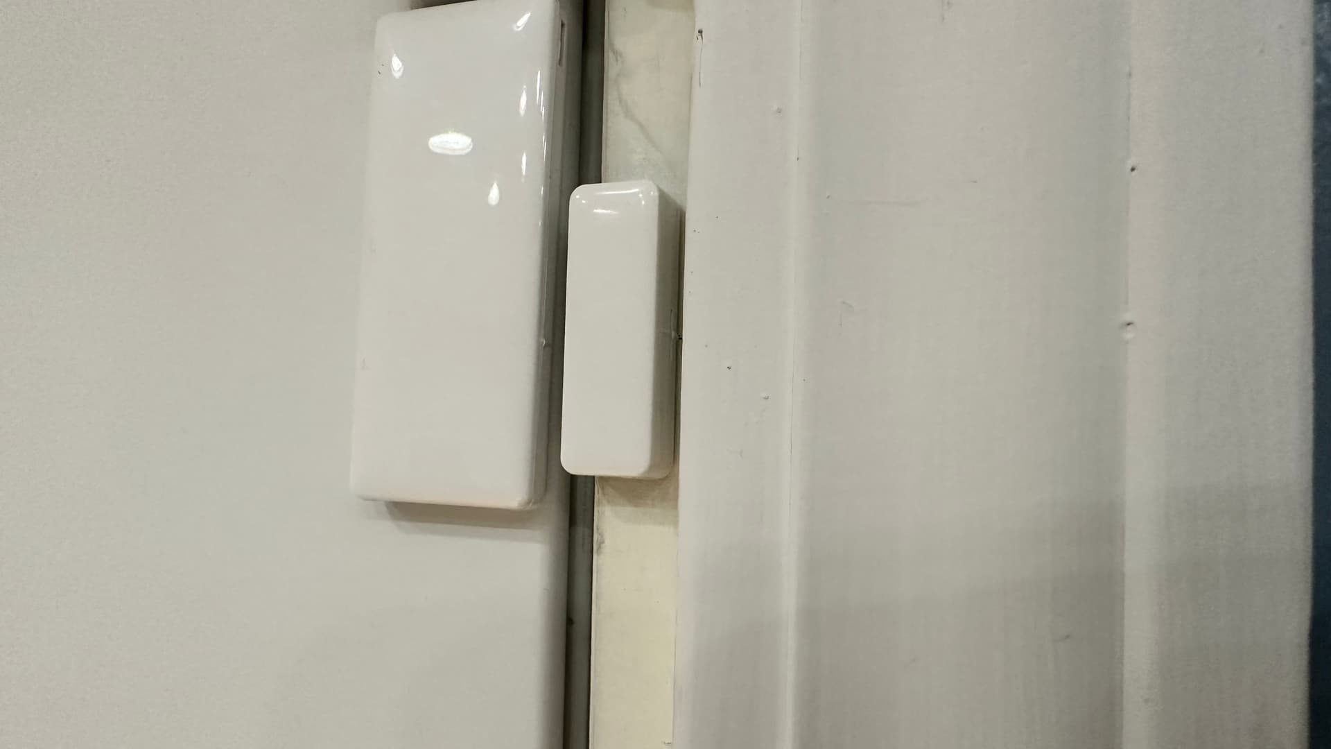

Also, can you provide a photo of the sensor installed on the window?
Thank you. I will grab the photos of the sensors. In the meantime, I ordered the DSC PG9303 sensors. They claim to be compatible with the IQ4. Is this correct?
Thanks for the quick reply. I took the sensor down due to the problems. One kept reporting the window was being opened. The other seemed ok but then apparently reported to the panel the window was open and it bypassed it when arming. They were just not reliable.

The reason I asked for the photo was to check the placement of the magnet, if it is not lined up with the correct spot on the sensor it will have a difficult time maintaining a closed status.
The magnet must be aligned parallel with the correct side and correct spot where the reed switch is. The sensor cannot properly close when the magnet is not aligned with the right location. There is a small symbol on the side of the housing which indicates where the reed switch is and where the magnet must go.
No worries, the drawings in the manufacturer manual showing the magnet alignment aren’t to scale and they don’t even place the arrow mark in the spot its actually found on the housing. It could certainly be improved.
