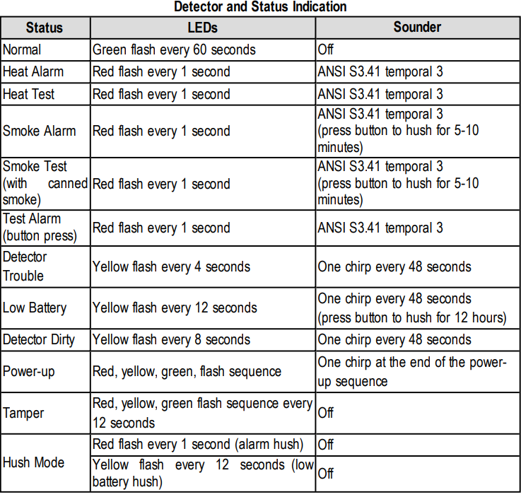

About how many seconds does it take for the LED to flash yellow?
