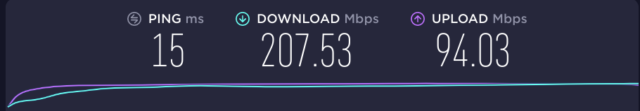

I didn’t think it would be the connection. But I just ran a few tests on it. Both worked, but for one of the tests using wifi the response was very delayed. That’s troubling as this is the fastest internet I’ve ever had, and I’m not running many devices on it at the time. Pretty much only the alarm system and two laptops and two phones.
Hopefully this was a one-off. It seems that every other time someone has come on the front porch, the camera has captured it and saved the video. The upsetting part was the one time it didn’t was one of the very few times that it wasn’t me coming on the porch. And the video I need captured is when it’s not me.

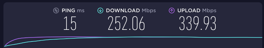

Previous speed test was done inside. The one below was done outside, just now, a few feet away from the doorbell. (So even further away from the access point.)
You are correct, the speeds (especially upload) was dramatically slower. But still fairly fast, yes? At least fast enough to handle the action in question, I would think.
I’m also using an acer chromebook, a fairly cheap device, to run these speed tests, so it’s likely not the most accurate picture of actual speeds.
To answer your second question, I just measured; the access point is 18 feet from the doorbell, with only the wall the device is attached to standing in between.
Those speeds are way more than necessary for a solid connection.
