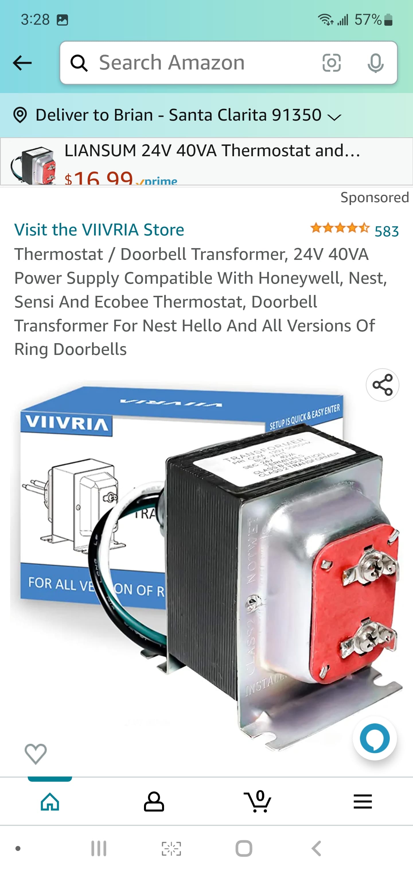

I installed an ADC Vb770 doorbell. It worked great for a day and then started having issues. I read some posts and found my transformer was under powered . Ordered and installed new transformer 24v 40VA . It resolved all issues, except when i push the button, the interior chime does not ring.
In addtion, when i measure the volts at the door, i am getting 40VA. Shouldnt it read no more than 24v
