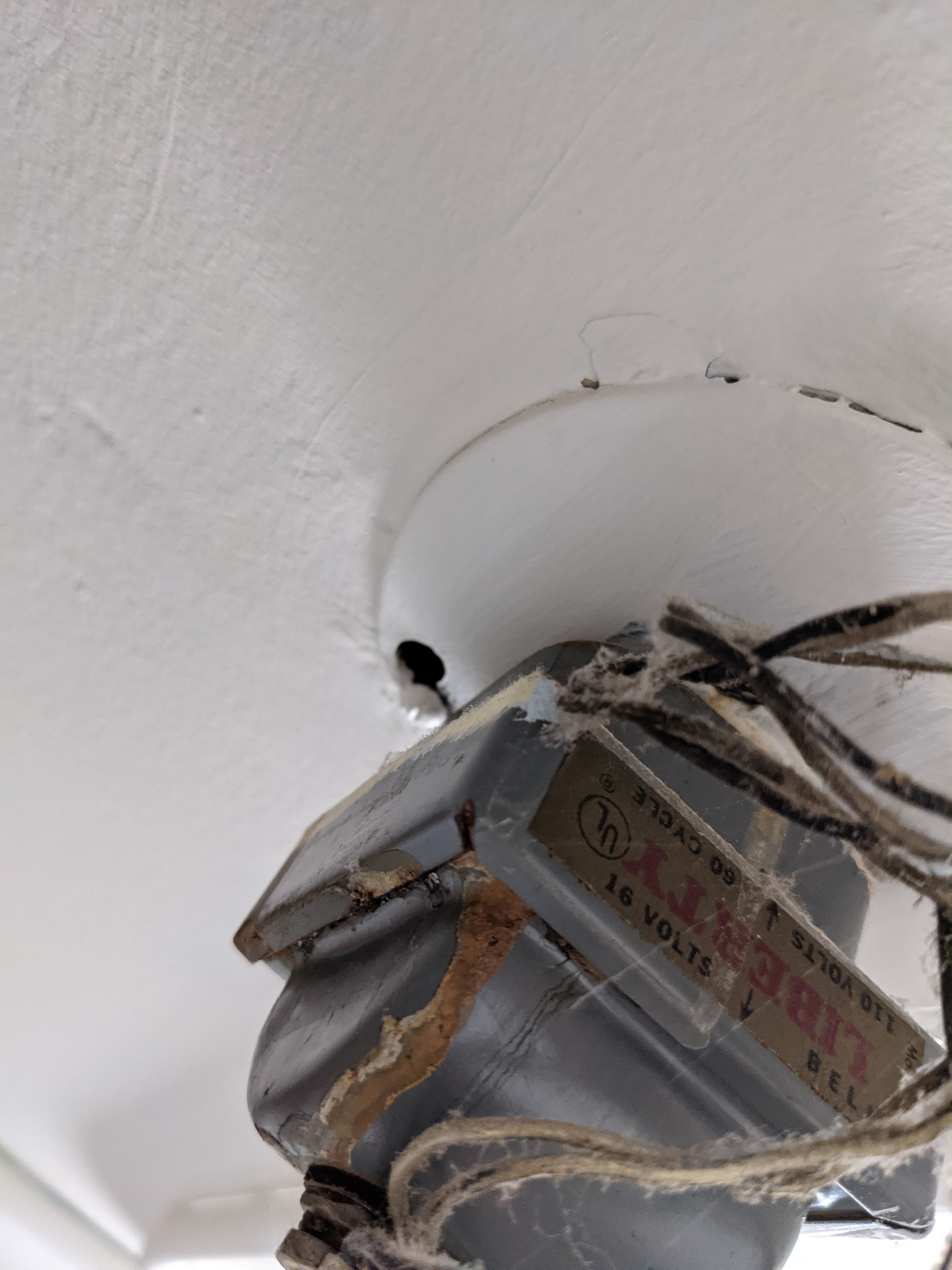

The doorbell is ringing the chime non-stop. Is this a wiring problem or something else I should be looking at?
Can you upload a photo of the wiring of your power module and chime?
What are the electrical characteristics, V and Va rating, of the doorbell transformer?

The transformer is 16V and 10Va. I’ve attached two pics. In case it’s hard to see, white wires from the power module are connected to the Front (ADC doorbell installed there) and transformer terminals on the mechanical chime. Gray wires are crimped to the wires that were connected to those terminals. The chime transmitter has 3 wires, one each for Front, Rear, and Transformer, and is connected accordingly. You may also see one extra wire that is not connected; it never was, probably from a 3rd doorbell that this old house had once upon a time.
Hmm, that’s some old cable. The cloth sheathed cable in there from the transformer, it is a little hard to tell but be sure there is no possibility of a short circuit the way it is resting in there.
