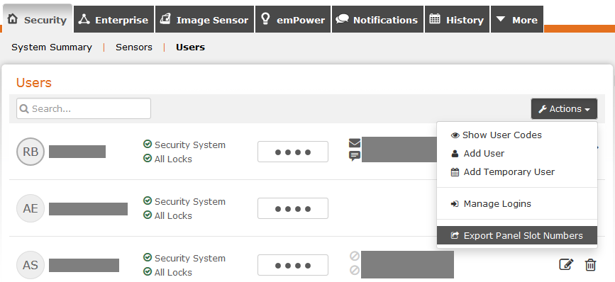

The Kwikset 910 has been around for a long time and works well with Alarm.com. Your Alarm.com account and 2GIG panel don’t appear to be synced up properly. It looks like Alarm.com is only aware of 2 “user slots” (2GIG user numbers) being used on your 2GIG panel. You can see which user slots Alarm.com knows about by going to Security → Users → Actions → Export Panel Slot Numbers.
All of your 2GIG users should show up in that spreadsheet. The frustrating part is I can’t seem to get them to sync up. I’ve done what we normally do to solve this problem and it doesn’t seem to be working. We may have to wait until tomorrow and get help from Alarm.com on this one.

Actually I just ran the panel slot number export report and it is only showing 2 of the 4 users.
Are the users being shown properly when the codes are put in at the door lock? (The users looks to have lock access, but not panel access, so I am not sure if the panel slot report would even include them.)
Great point Jason, I will check that.
You are correct Jason, because they do not have panel access they dont show on the report. They are coming across correctly now on the notifications. Thanks again for the quick help.
