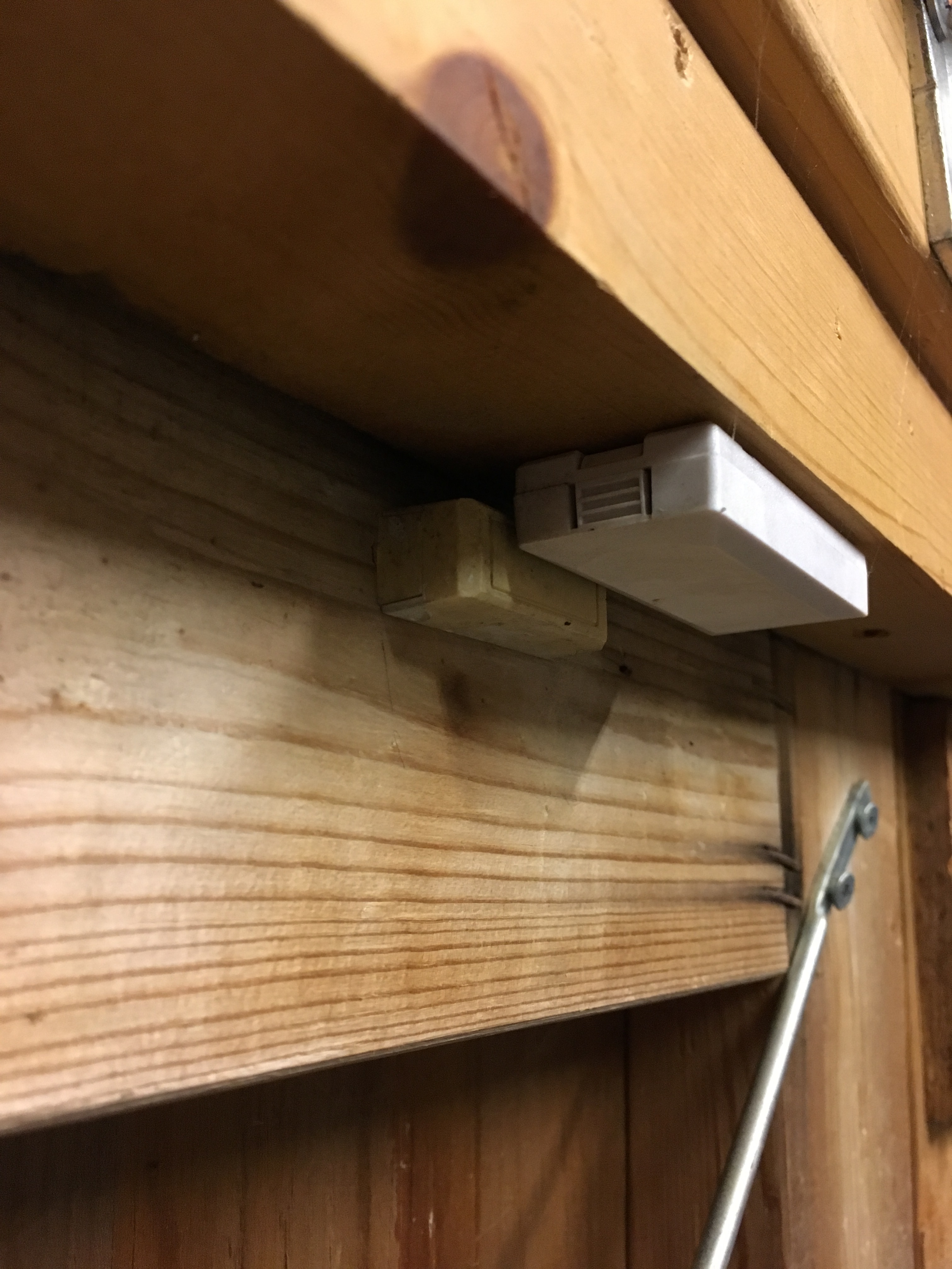

It may help to post a photo of the sensor as it is installed on the door.
Here is my system, the dog kennel is approx 75 yards from the main panel. The distance shouldn’t be the problem because the thermostat works fine and its inside on the back wall further than the door sensor.
The magnet appears to be misaligned to the sensor. The magnet should never protrude beyond the end of the sensor housing. The three indicator ridges on the sensor cover should line up in the center of the magnet when the door is closed. The way it is installed it looks like those ridges would line up at the far end of the magnet. This would be the easiest thing to test first.

Thanks, moving the magnet fixed the problem.
