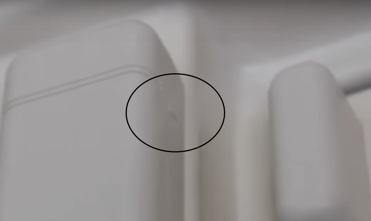

- Do you have the magnet lined up with the little arrow on one side of the sensor?

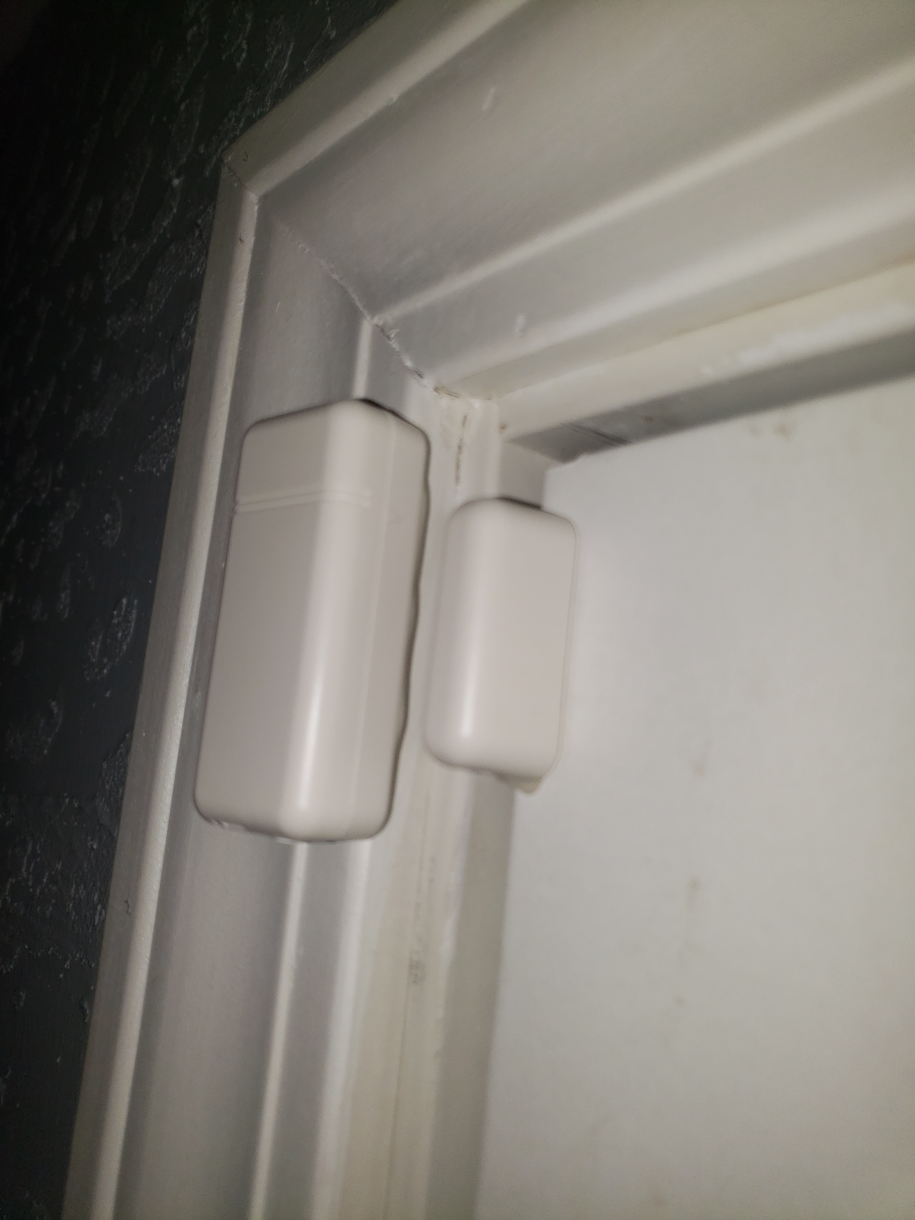

Hi Roy, yup, the plastic tabs are removed. I added them during setup in the setup wizard. And the two that are giving me problems look like this:
The magnets look like they are set too low along the side of the sensor.
The magnet needs to be roughly centered on the arrow on the sensor case. In your image it looks like the top of it starts there, putting it too far from the reed switch.

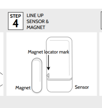

See image from the manual below:
yup, that fixed it, thank you !
