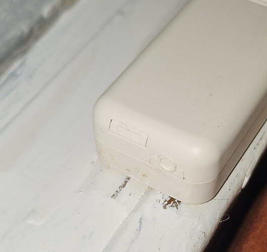

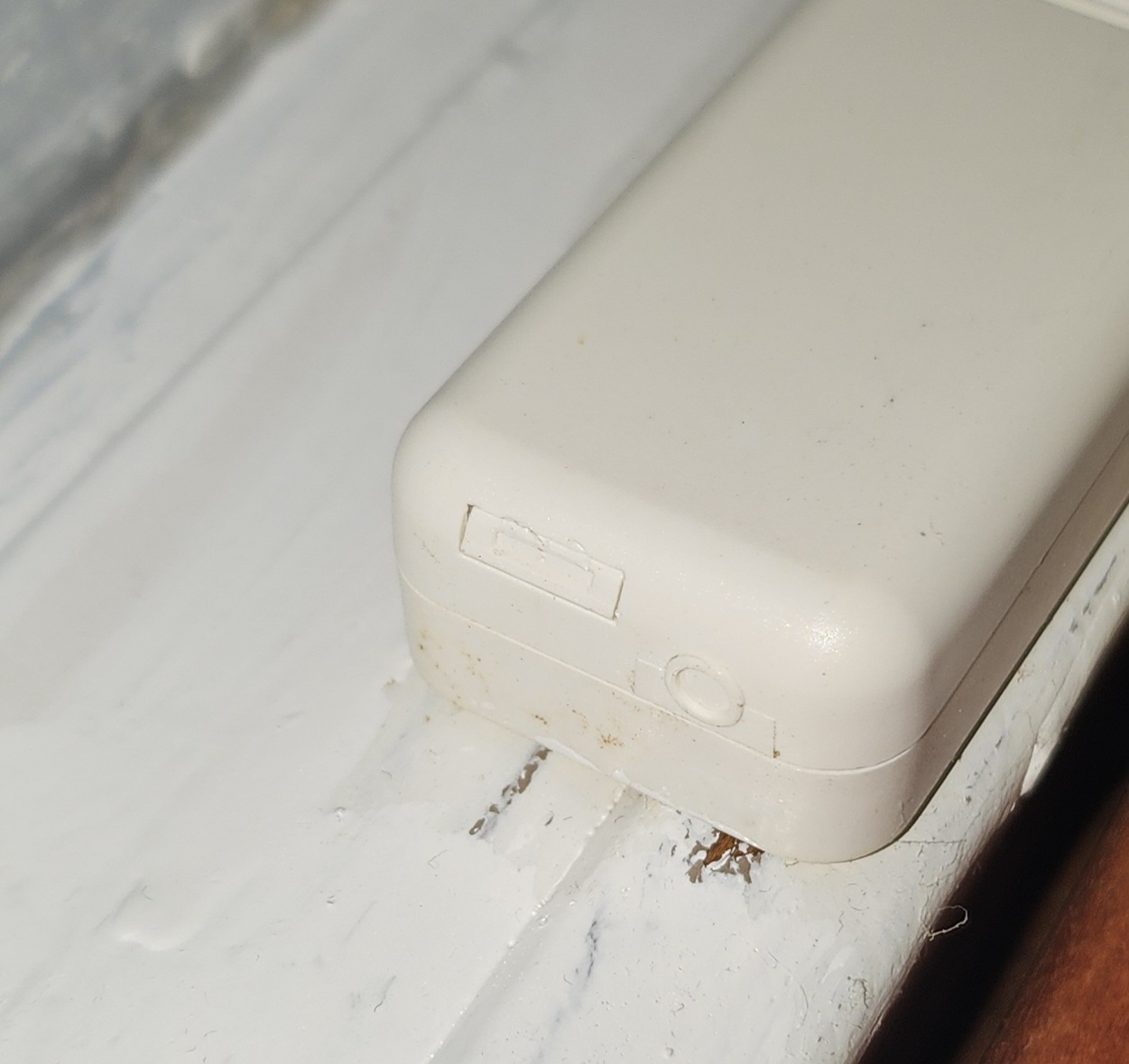

Also, I’ve attached a picture of the the sensor casing clip that secured the sensor in place so you can check if there’s any physical damage or defect that might be causing the issue.
The sensor casing seems fine there. If the casing was a little loose, where the switch is just barely held shut, then it can certainly trip randomly. This might be triggered by vibration, slamming doors, etc., usually it is due to a loose connection of the sensor cover, but yours seems ok. The switch itself inside the sensor may be the issue. If you notice it again I would open the sensor and reconnect the cover securely.
