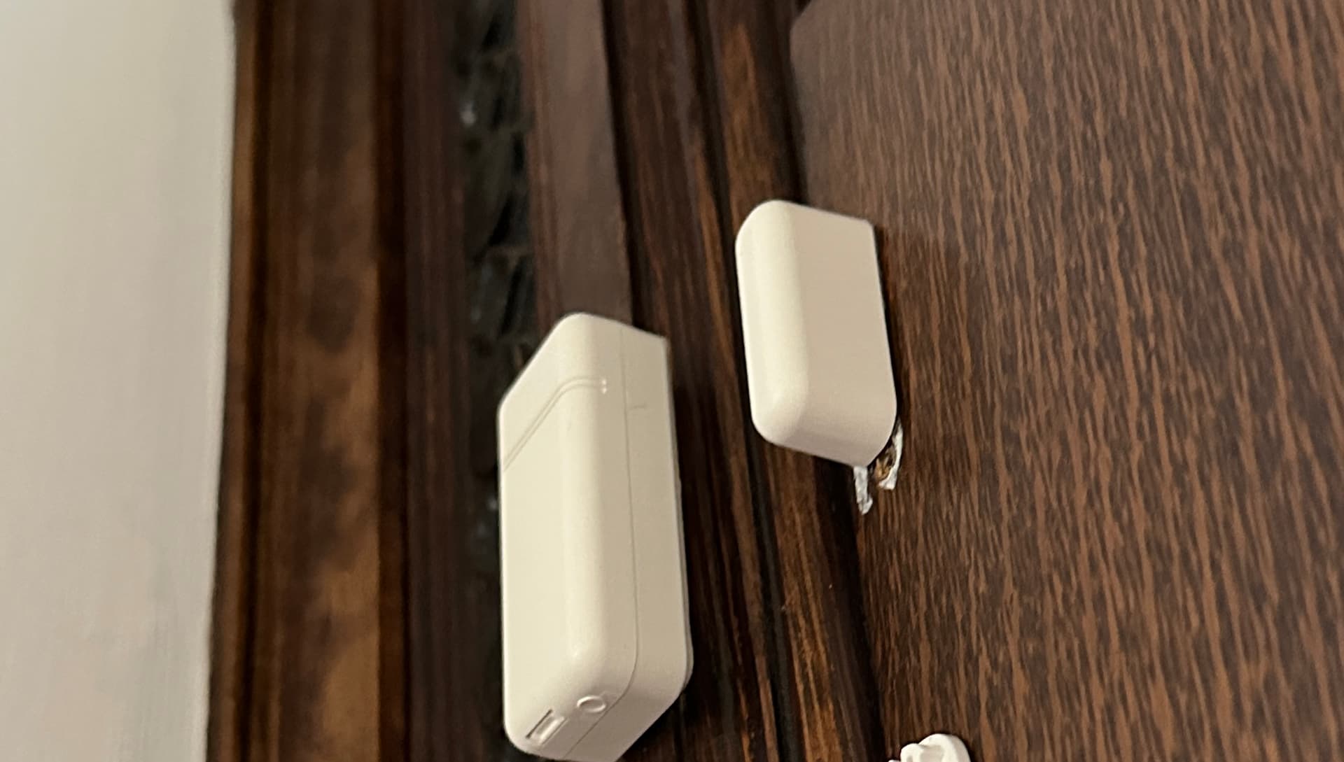

Sure. The nearest is the front door. The middle is the basement door. The furthest is the back door. I seem to have resolved the issue (for now) with the basement door by moving the sensors to the middle of the door, above the handle, which is ugly but whatever: the door is badly bowed, and the middle is where the door and frame are most closely aligned—but again, it seemed to be working fine initially and the front door also has a bit of a front-back gap between the components:
And if the problem had been that the pieces were mounted too far apart, then I would have expected the issue to have manifested as the door always registering as open, rather than never registering as open.

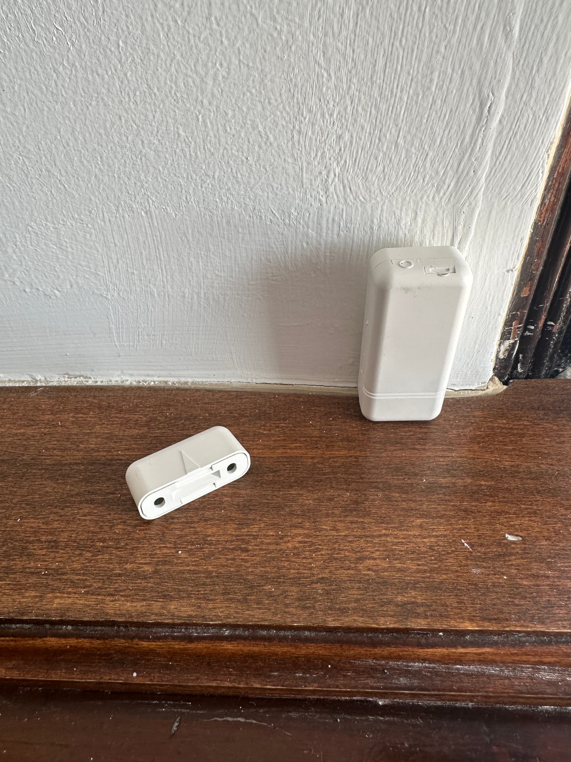

Here is a picture of the back door sensor:
Now, you might observe that it is not mounted on a door or window at all. That’s because after it stopped seeming to work and I started wondering about its success reaching the panel, I took it off, and started walking toward the panel with the components together, moving them apart at each step. It started registering as open (and then again as closed) when I was, I would guess, about 20 feet away. It kept doing that as I got closer (duh) and then stopped, when I was walking away doing the same thing, at about the point it had started when I was walking toward it. It currently registers as closed even though the sensor components are pretty far apart. I haven’t replaced it on the door because doing so seems pretty pointless, and because having removed it I no longer have the cute little 3M tape guys that fit so nicely.
The basement and back door both have “poor” dbm (-88 and -90), respectively, and “perfect (8)” and “fair (4)” packets in the sensor test page.
If the top picture is the basement door, from to picture it looks like they’re still too far apart to me. It’s tough when the door molding is recessed like that. But I think you might still run into trouble with it like that.
When I deal with those door frames, I usually put the sensor (the larger piece) on the door and the magnet (the smaller piece) on the frame. That lets me fit the magnet closer and the sensor can be right at the edge of the door.

The top picture is the front door which is working fine, actually.
