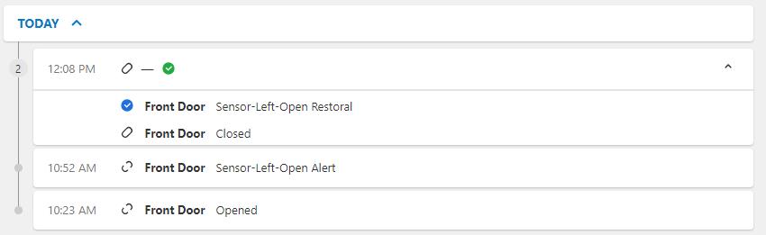

The door issue happened again earlier today with the front door. I noticed the door was showing as Opened at 10:23 AM even though the door was not opened at that time. I went and opened and closed it multiple times, but it would not revert back to Closed. I then got the Sensor-Left-Open Alert after 30 minutes. Then without opening or closing it, the sensor reverted back to Closed and the Sensor-Left-Open Restoral alert came through at 12:08 PM. See activity in screenshot below.
I am thinking I should try replacing the sensors in the door, but am open to other perspectives. Thanks!
What kind of sensor is in the door? There may be a magnetic recessed sensor or a plunger style recessed sensor. Feel free to post a photo of the sensors and we can help identify. Magnetic sensors may be misaligned with the magnet, and old plunger sensors may not depress all the way to close the circuit.
