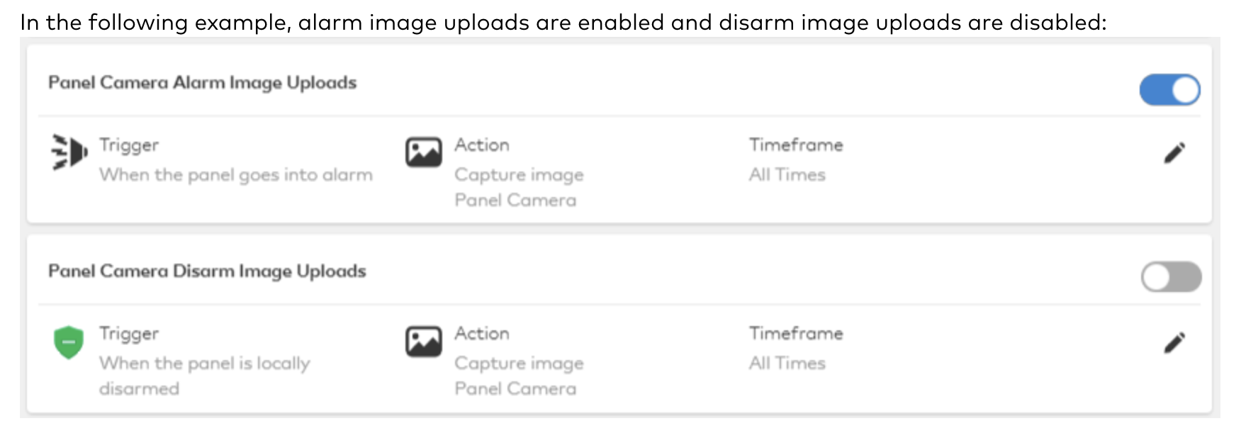

To set up IQ Panel camera images:
- Log into the Alarm.com Website.
- Click Automation .
- Click Rules, if not selected already.
- To enable/disable panel camera disarm and/or alarm images, click the toggle switch for the Panel Camera Alarm Image Uploads and/or Panel Camera Disarm Image Uploads automation rules.
To configure recipient notifications:
- Click Edit for the automation rule to configure.
- Click + Add Recipient .
- Select any recipients to be notified from the Address Book dropdown. If the intended recipient is not listed, click + New to add a new recipient address.
- Once desired recipients are selected, click Close .
- Click Save .
